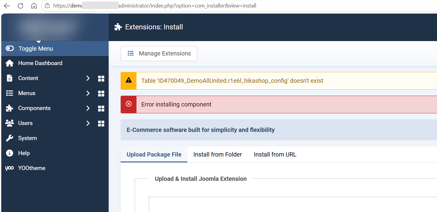

Hello HikaShop support,
I am encountering an error when trying to install HikaShop for the first time on a Joomla website.
This is a fresh installation with no previous HikaShop data present.
Error messages shown after installation attempt:
1. Warning: Table 'ID470049_DemoAllUnited.r1e6l_hikashop_config' doesn't exist
2. Error: Error installing component
Could you please advise what might be causing this and what the recommended steps are to resolve it?
Thank you in advance.
Kind regards,
Lumiga
Kind regards,
Lumiga

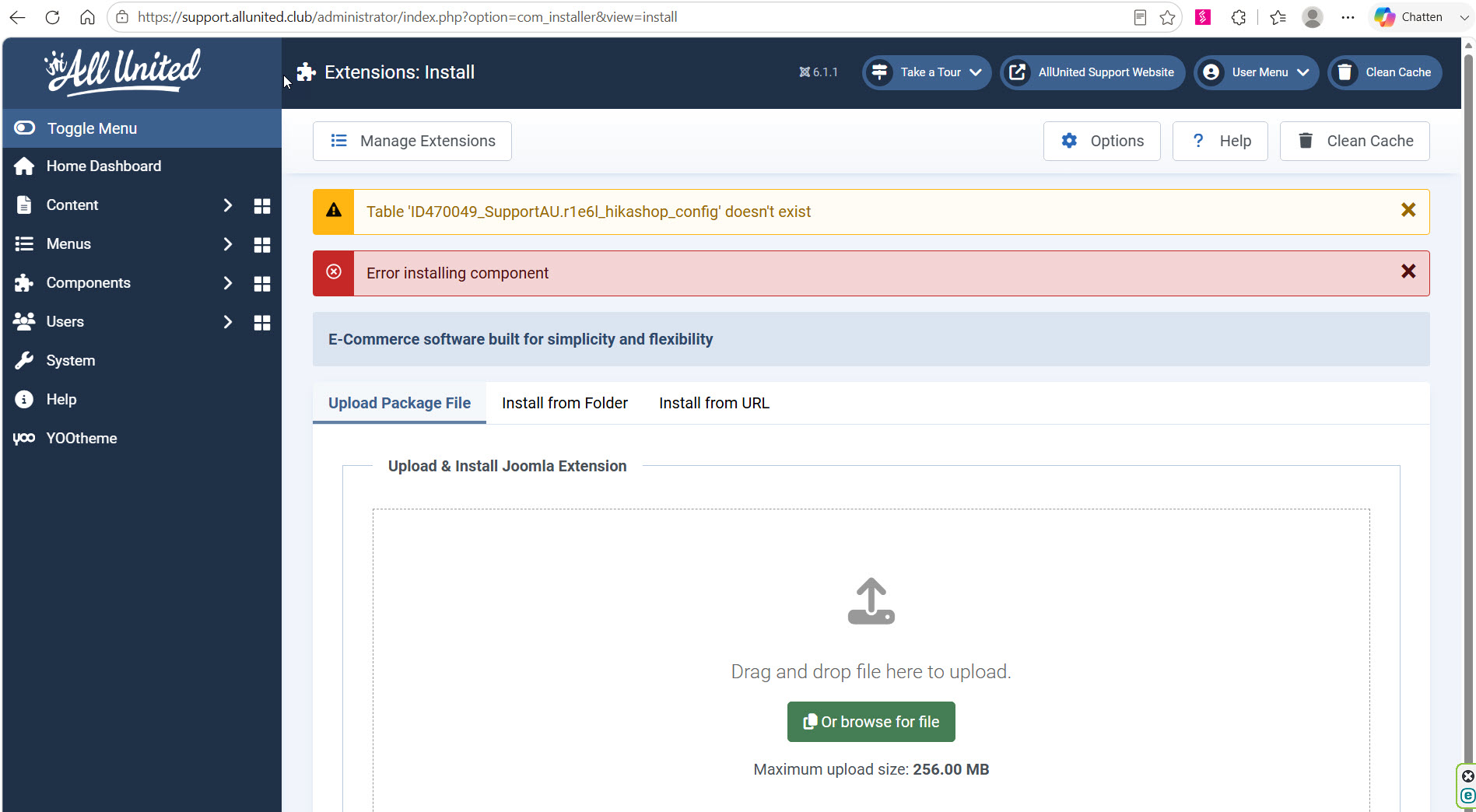

2 months 16 hours ago #372397
I had the hosting provider look into it, but there was nothing on their end that could be improved. I also downloaded a fresh installation file and checked the other points you mentioned, but everything looks correct there.
I then installed a clean new website on the same hosting environment and installed HikaShop on it — and that worked without any issues. So I suspect the problem is specific to the existing website.
What could be causing HikaShop to fail installation on this particular site? I am using AdminTools, and I also tried resetting the .htaccess to the default Joomla version, but that didn't help either.
Do you have any other ideas on how to resolve this?
In the Joomla log we see only this:
026-06-27T12:04:21+00:00 WARNING 212.83.80.222 jerror Table 'ID470049_DemoAllUnited.r1e6l_hikashop_config' doesn't exist
Kind regards,
Lumiga

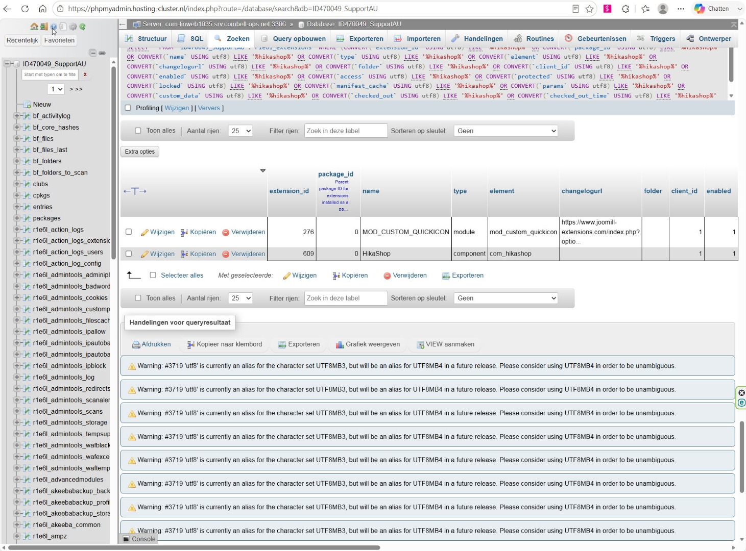

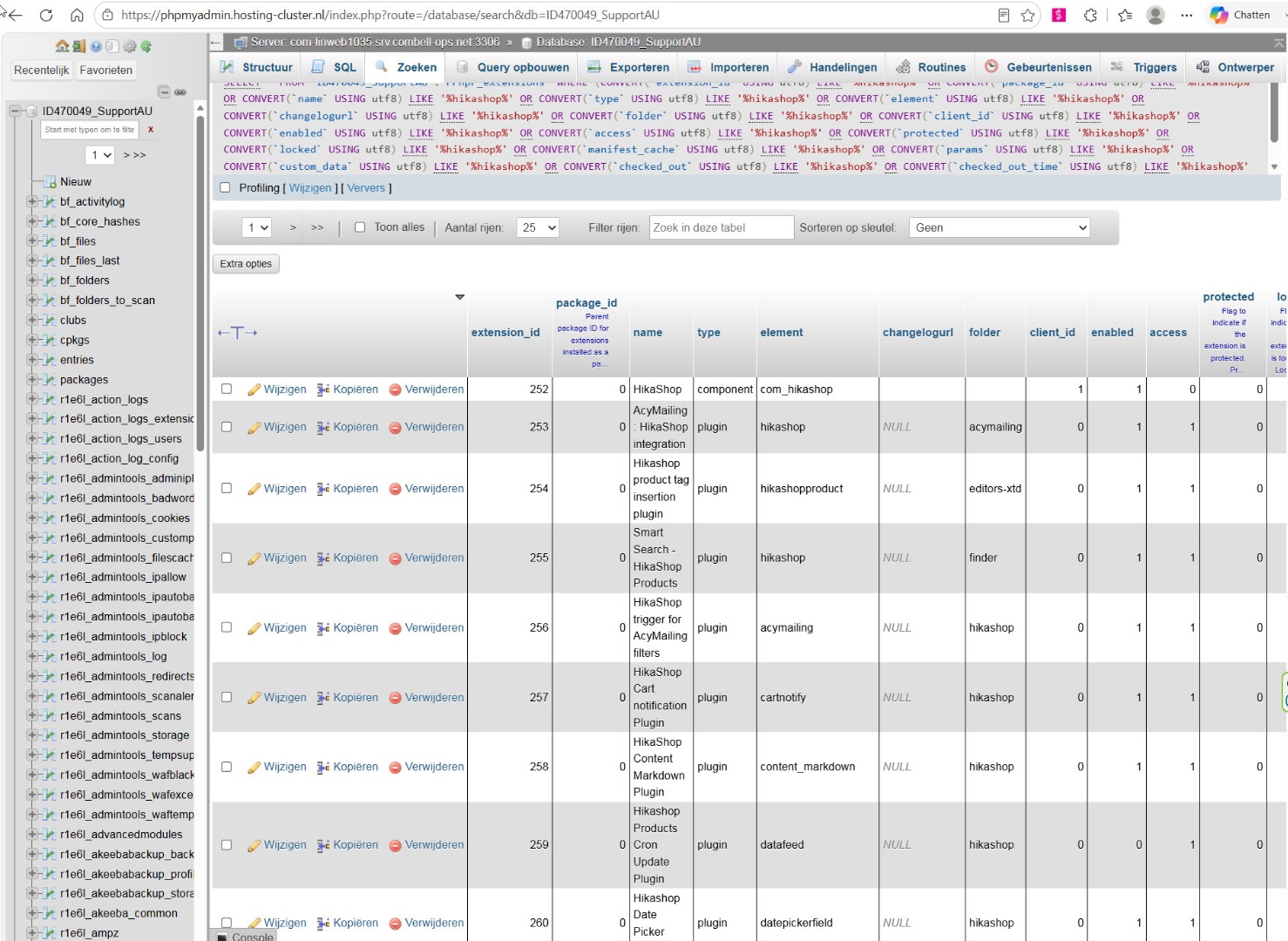

  • Posts: 637
  • Thank you received: 26

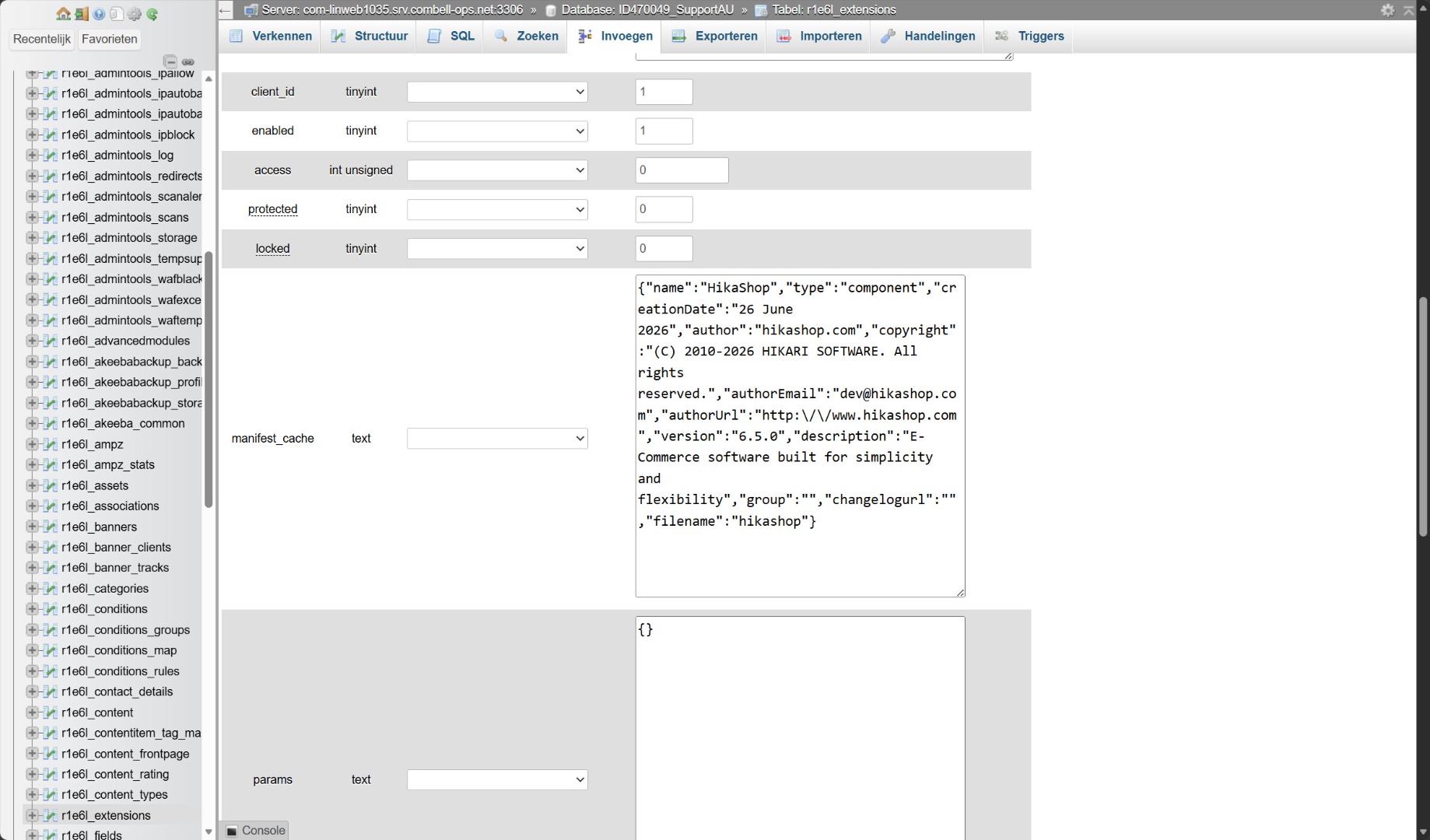

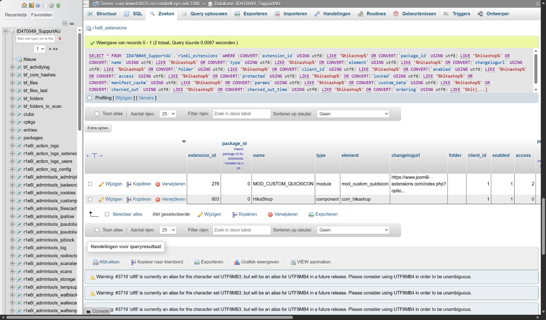

1 month 4 weeks ago #372412
After reading your last replay, I did an extra test using the same username and password on the same database. I first emptied the database, deleted all the website files, and installed a fresh Joomla 6.1.1.
After installing HikaShop on this clean setup, we don't experience any issues. So it appears that something within the existing website is causing the problem.
In the database of the website with the error, we can see the following HikaShop records in the extension table.
See images 201 and 202:
Kind regards,
Lumiga
Kind regards,
Lumiga
Last edit: 1 month 4 weeks ago by Lumiga.
  • Posts: 86080
  • Thank you received: 14187
1 month 4 weeks ago #372414
Try deleting this entry and then installing HikaShop again. Maybe that will help.

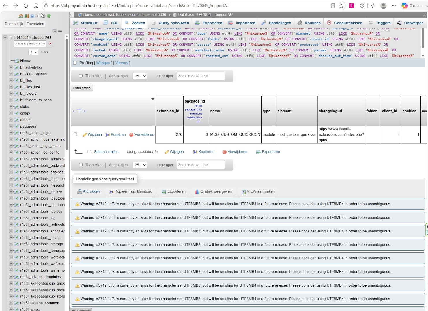

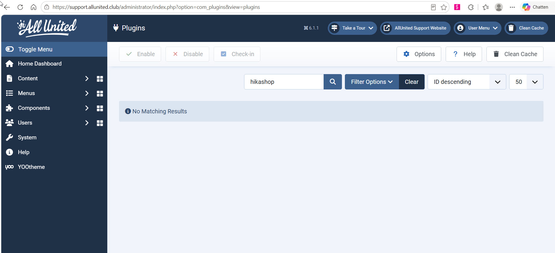

  • Posts: 637
1 month 4 weeks ago #372428
We did that — see the screenshots before and after, and the error.
It's still not possible to install HikaShop on this site. After trying, the only thing we see installed is the component and plug-ins. But we do not see the plugins in Joomla..
