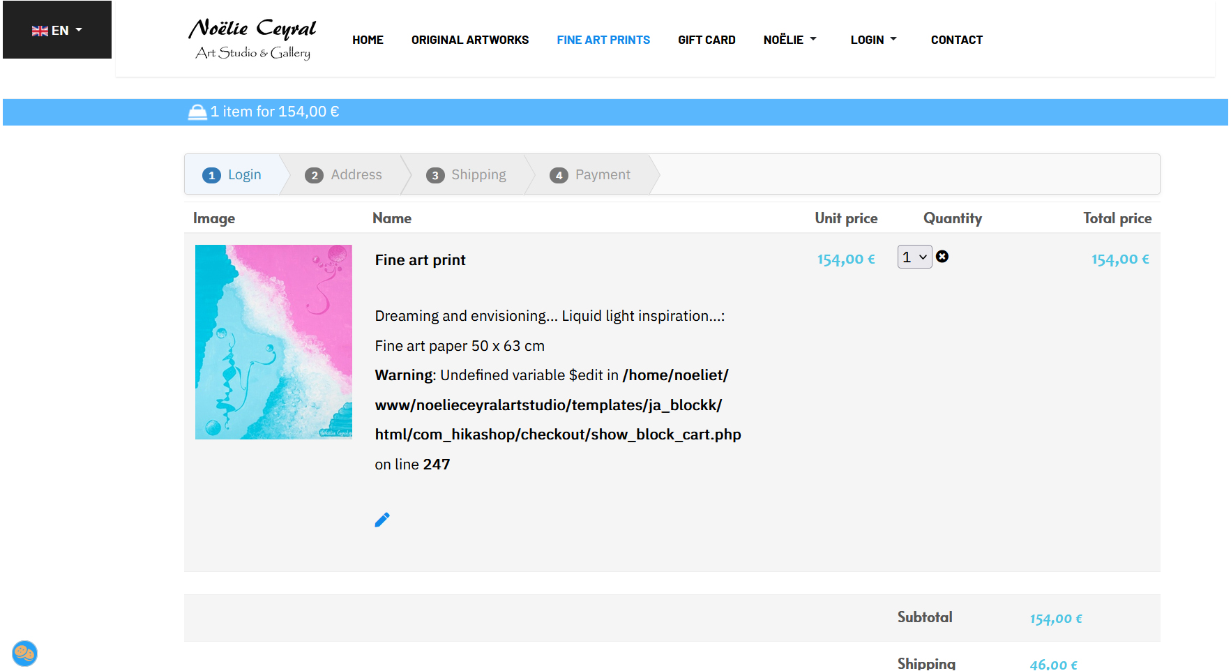

3/ I’m having an error on the checkout page when I add a product to the cart. See attached image.

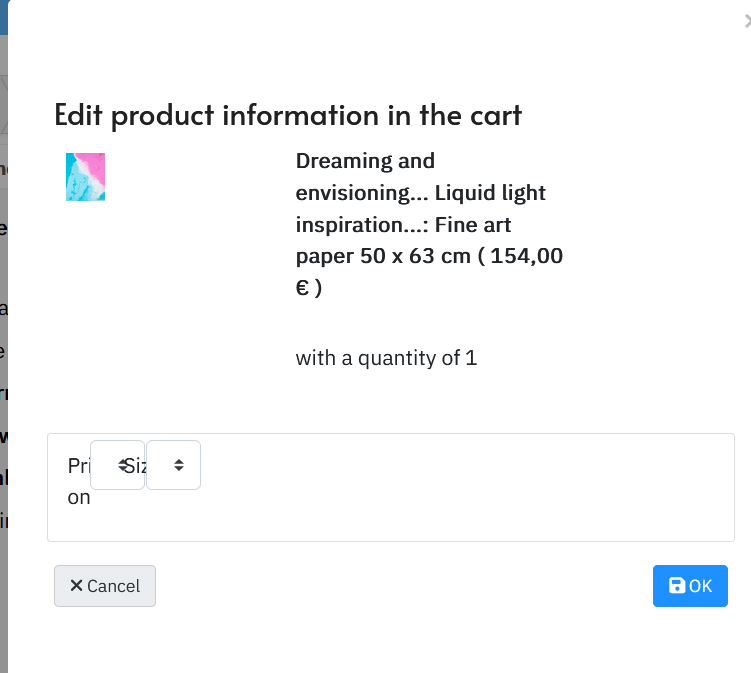

4/ When I click on the product at the checkout page in order to change the characteristics’ values, the page doesn’t show up properly compared to how it used to look like. I have attached an image for this issue also.

Thank you for the details and the screenshots, they point clearly to the cause.
The warning on your screenshot is the key:
Undefined variable $edit in .../templates/ja_blockk/html/com_hikashop/checkout/show_block_cart.php
That file is a HikaShop view override stored inside your template (ja_blockk). It is an old copy of our checkout cart view, made for a previous HikaShop version. In HikaShop 6.5.0 that view changed, so your outdated copy is now out of sync and breaks:
- issue 3 is the warning it prints in the cart
- issue 4 is the same file rendered in edit mode, which is why the "Edit product information in the cart" popup no longer looks right
Overrides are not updated automatically when you update HikaShop, so after a major update they have to be updated or removed by hand if they cause problems. To fix issues 3 and 4, edit or remove this file:
If you did not need a custom version, simply delete it and HikaShop will use its own up to date view.

With regards to issue 4, I went to :
/media/com_hikashop/css/hikashop.css via FTP
At line 290, I changed display from grid to block and that sorted the issue. However, the price doesn’t change automatically when we change the characteristics. I think it used to do that before though. Also, as I had to make that change via ftp, I guess that it will disappear from my files as soon as I update to the future new hikashop version. It seems that it might be a problem with the new hikashop version. I updated to 6.5.2 before I made this change.

Yes, you should add your CSS via the backend or in your template's custom CSS (what I would recommend).
So, the first thing is to check how your template allow for custom CSS and then copy / paste the custom CSS you want to persist in it.
