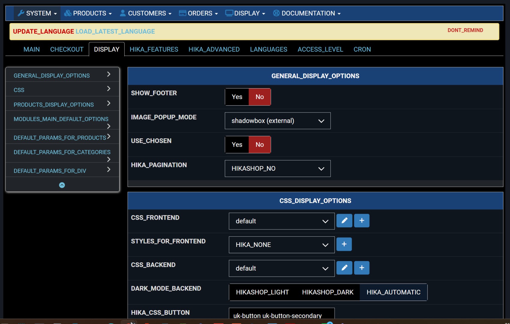

After updating HikaShop from 6.5.0 to 6.5.2, the translations are no longer
loading anywhere in the back-end. Instead of the normal texts we now see the
raw language keys everywhere (for example SHOW_FOOTER, IMAGE_POPUP_MODE,
USE_CHOSEN, and even the update notice itself shows as
UPDATE_LANGUAGE / LOAD_LATEST_LANGUAGE). A screenshot is attached.

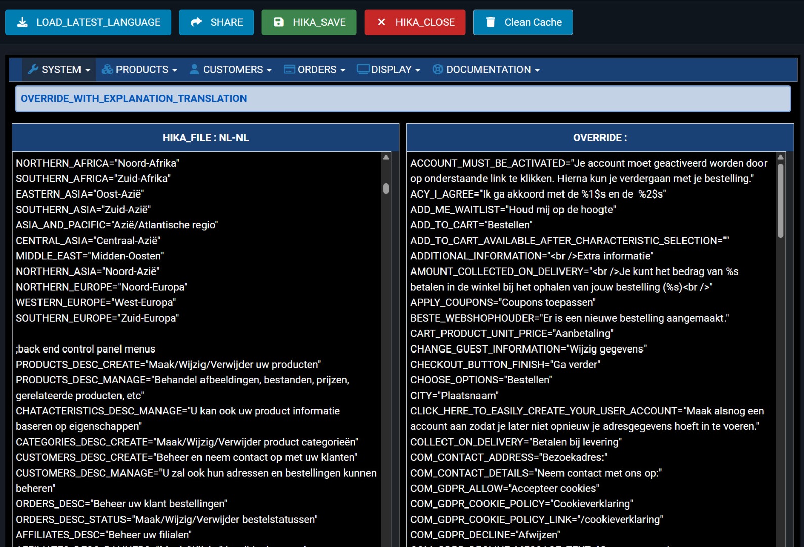

The important point: the Dutch language file is definitely present and
installed. We have verified this:
- In HikaShop > System > Configuration > Languages, Dutch (nl-NL) is listed
as installed. When we open it with the Edit icon, the full list of
translated strings is shown, so the file exists and is filled.
- Via FTP the file nl-NL.com_hikashop.ini is present and not empty, in both
/language/nl-NL/ and /administrator/language/nl-NL/.
- The files and folders have the correct read permissions.

The Dutch translation itself is fine. We checked the nl-NL file our translation server delivers, and the one in our repository: both parse without any error, and so do the language files inside the 6.5.2 package. So the raw keys do not come from a broken file on our side.
What your screenshot shows is what happens when Joomla ends up with zero strings for HikaShop, which is why you get the keys instead of Dutch and instead of English. Since Joomla 5.2, each language ini file is parsed once and the result is stored in a cache file under administrator/cache/language, named after the ini file and its modification date. If that cache entry was created while the file was being replaced during the update, it holds an empty list of strings, and it keeps being used until the ini file gets a new modification date. We reproduced exactly your screenshot that way here.

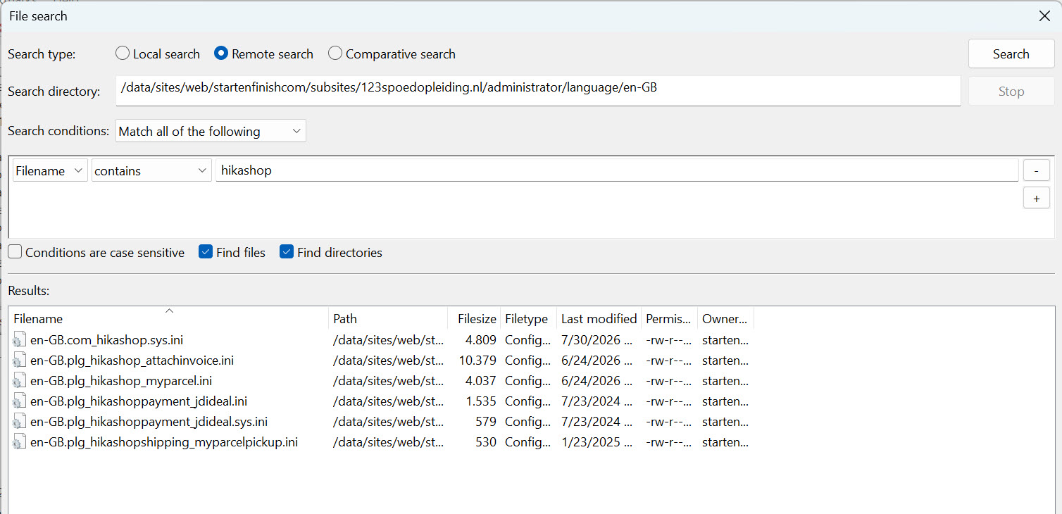

Thank you, that pointed us in the right direction. Here is what we found.
First a correction to our original post: our back-end runs in English (en-GB), so the file that matters here is en-GB.com_hikashop.ini, not the nl-NL one. Apologies for the confusion.
We followed your steps:
1. Via FTP we deleted everything inside administrator/cache/language (there was no cache/language folder). After reloading the back-end, the raw keys
were still there.
2. We set Global Configuration > System > Debug Language to Yes and opened a HikaShop back-end page. In the "Language files loaded" list, com_hikashop is not loaded from any location - all four candidate paths are marked as not found, while com_hikashop.sys loads fine. The full "Loaded" and "Untranslated" exports are attached (two .txt files).
3. That made us check the folder administrator/language/en-GB itself over FTP: and the en-GB.com_hikashop.ini is simply not there. The folder only contains en-GB.com_hikashop.sys.ini (4.8 KB) plus a few plugin language files (screenshot 5 attached).

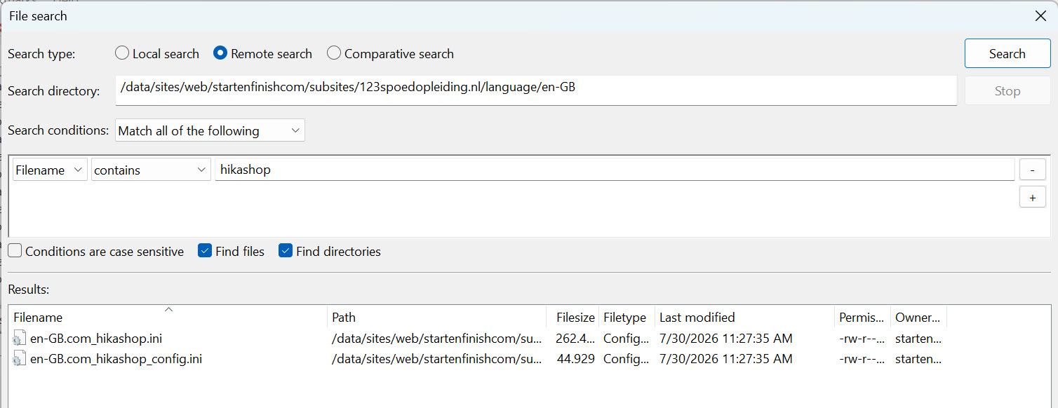

So this is not a stale/empty cache entry - the main .ini was never present on disk. We also confirmed there is no unprefixed com_hikashop.ini in /language/en-GB/ or /language/nl-NL/. See screensho 6.
4. We then checked the Apache error log and found this repeatedly, from our host's (Combell) ModSecurity firewall, on back-end requests:
ModSecurity: Rule ... [id "35013"] ... Execution error - PCRE limits exceeded (-8): (null). [hostname "123spoedopleiding.nl"] [uri "/administrator/index.php"]
The firewall aborts the request when that rule exceeds its PCRE match limit while scanning the content (so it is not a byte-size limit as such).
Our reading is that this interrupted the writing of en-GB.com_hikashop.ini during the update: the small en-GB.com_hikashop.sys.ini has today's date, but the main .ini was never written.
Fix: we extracted en-GB.com_hikashop.ini from the 6.5.2 package and uploaded it manually via FTP to administrator/language/en-GB/. The back-end shows all texts again.
