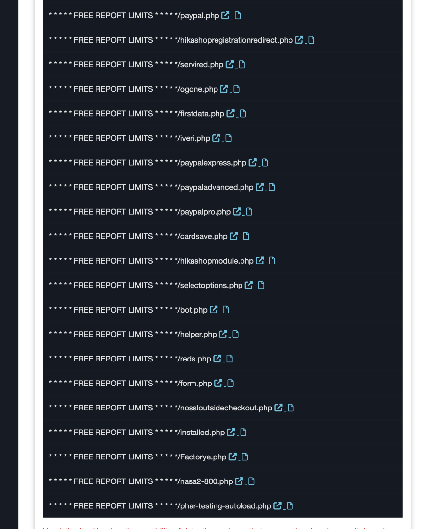

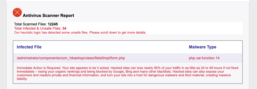

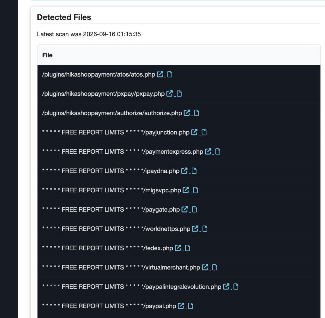

Vulnerabilities detected in Hikashop.
My website was hacked and I updated Joomla to 5.4.8 as I can't do Joomla 6 because PHP needs to be 8.3.
I installed Website Antivirus Scanner for Joomla and it has reported many files in Hikashop as being vulnerable, almost all of the payment plugins..
Whether it is or isn't, why is it being reported and what can be done to fix this please?
See attachment

I checked the list of files in your report and all of them are legitimate HikaShop files. Nothing there is a file added by a hacker, they are all part of the normal package: the payment plugins, the FedEx shipping plugin, our modules, our fields and our views.
The detection type displayed in the report, php.var.function.14, is a heuristic rule of that scanner. It flags normal PHP constructions, like calling a property or a method whose name is stored in a variable, or using base64_decode to pass data in a URL. HikaShop uses these constructions in many places, and so do many other extensions. Akeeba Backup had exactly the same php.var.function.14 detection on one of its own files and it was a false positive there too.
So that report alone does not mean that these files are infected. Note also that the free version of that scanner hides most of the paths behind FREE REPORT LIMITS, so you cannot even see which files it is actually talking about.
That said, as your website was really hacked, it is worth verifying instead of just ignoring the report. The simplest way is to download the package of your HikaShop version from your account on our website and to install it again on your site. That overwrites every HikaShop file with a clean one, the plugins included. Then run the scan again. If the same files are still listed, it is the heuristic rule and not an infection.
