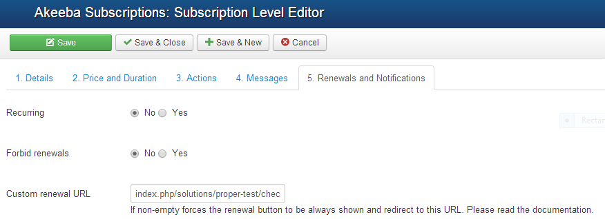

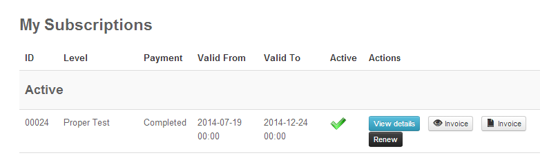

2. In the email sent by Akeeba Subs it sends a URL to manage your subscriptions, you go there and it takes you to a "My Subscriptions" page. On there I can see my current order, when I try click "renew" (Image: AkeebaURL3) it doesnt use the custom URL I specified in the Subscription Level itself. Please see attached image (AkeebaURL1). Basically that URL never applies itself correctly, I suspect an issue with the logic in the code itself.
The link that should be used for the custom URL is actually a Hikashop Link with Checkout specified, so basically they just buying my item again when they click the renew button. But the URL is not applied. ie. "index.php/solutions/proper-test/checkout" when appended to my domain will check out the item and start the checkout process.

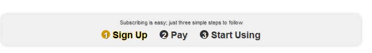

(Image: AkeebaURL2) is the actual page I get to when I click Renew.

Re 2. Managed to sort it out, seems there was a problem with the $CanRenew and $RenewURL, so just told it to always use the custom value irrespective :)
