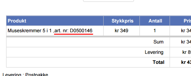

10 years 1 month ago #223734
ip-studio wrote: Hi
Just add :
echo $product->order_product_code;
where you except to see the code in plugins/hikashop/attachinvoice/attachinvoice/invoice.php
This works fine, and my product code(red underlined) is displaying like this in the invoice:

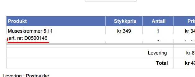

I need it do display like this (red underline), on a separate line.
Any advice on how to fix this ?
  • Posts: 84952
  • Thank you received: 13839
10 years 1 month ago #223765
You can do like that:
echo '<br/>'.$product->order_product_code;

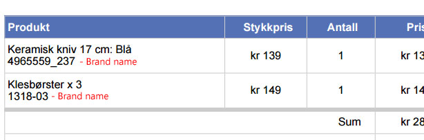

It works perfect. One last question:
It is possible to include the brand name of the product in the invoice. Plese see image on how I want it to look (brand name is illustrated with red)
Any advice on how to do this ?
Last edit: 10 years 1 month ago by river.

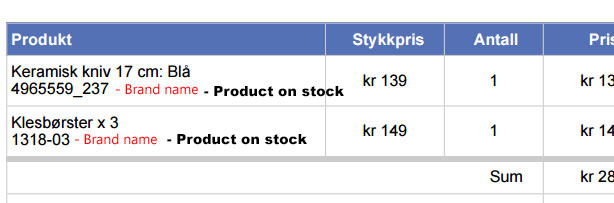

  • Posts: 344
9 years 8 months ago #239857
Note: Hikashop 2.6.1
OK I will just continue using this thread since I am probarly the only person with this request.
It is possible to include the product quantity or a message saying: "Product on stock" in the product invoice.
Like this:
I only need this message to be displayed if the quantity of the product is 1 or above.
I have some products the have Quantity: Unlimited, but on these products I do not need the message to be displayed since these products are not in my own warehouse.
Looking forward to hear from you.
  • Posts: 84952
9 years 8 months ago #239861
$productClass = hikashop_get('class.product');
$productData = $productClass->get($product->product_id);
if($productData->product_quantity>0) echo 'Product on stock';
