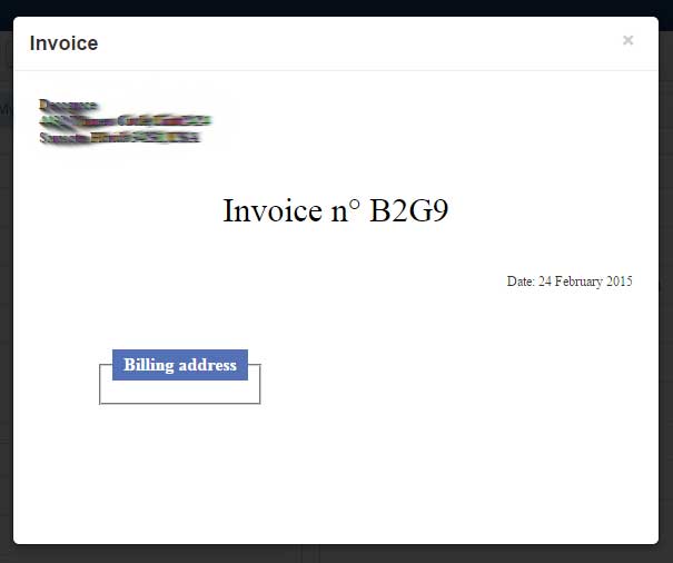

When I go to the back end and generate an invoice by clicking the invoice button in the order detail screen, the popup that opens to display the PDF invoice displays a partly formed invoice only. I am attaching a screen shot of that popup.
Also, I do not find any invoice generated in the /plugins/hikashop/attachinvoice/attachinvoice/invoices directory. It seems that the plugin is not able to create the PDF invoice as a result of which the order confirmation email does not get sent out at all to the customer and neither does the payment confirmation email gets sent out to the administrator.

I notice that if I comment out the following code in /plugins/hikashop/attachinvoice/attachinvoice/invoice.php then everything works fine and the confirmation and payment notification mails get sent out (though obviously the Billing and Shipping addresses do not get printed in the attached invoice):
<fieldset>
<legend><?php echo JText::_('HIKASHOP_'.strtoupper($oneAddress)); ?></legend>
<?php
$override = false;
if(!empty($order->order_shipping_id) && $oneAddress=='shipping_address' && method_exists($currentShipping, 'getShippingAddress')) {
$override = $currentShipping->getShippingAddress($order->order_shipping_id);
if($override !== false ) {
echo $override;
} else {
$addressClass = hikashop_get('class.address');
if($app->isAdmin()){
$view = 'order';
}else{
$view = 'address';
echo $addressClass->displayAddress($order->fields,$order->$oneAddress,$view);
</fieldset>

I think you should have a PHP error due to a too old HikaShop version.
The function "displayAddress" is not available in HikaShop 2.2.2 ; you should update to the last one (2.3.5)

Meantime I have found a replacement for the offending displayAddress() function call and am giving it here in case some one else can benefit from it.
	echo $override;
} else {
	/* The following block to be commented out
		$view = 'order';
	}else{
		$view = 'address';
	/*Add the following block to replace the above*/
	$html = hikashop_getLayout('address','address_template',$params,$js);
	if(!empty($order->fields)){
		foreach($order->fields as $field){
			$fieldname = $field->field_namekey;
			if(!empty($order->$oneAddress->$fieldname)) $html=str_replace('{'.$fieldname.'}',$fieldsClass ->show($field,$order->$oneAddress->$fieldname),$html);
	echo str_replace("\n","<br/>\n",str_replace("\n\n","\n",preg_replace('#{(?:(?!}).)*}#i','',$html)));
	   /*End of new lines added*/
Besides the above change you will also need to add one more line before the foreach loop which processes the addresses.
/*Add the following ONE line*/
$fieldsClass = hikashop_get('class.field');
foreach($addresses as $oneAddress){ .............................
Thanks for your help and for a super component.

Can you just help me with the following code that I have changed in /plugins/hikashop/attachinvoice/attachinvoice/invoice.php to display addresses in my invoice (because $addressClass->displayAddress is not available to be used in Hikashop 2.2.2). This code is working fine on the front end but it is causing problem while displaying an address when the invoice is to be printed from the back end. If I comment out printing addresses altogether from the invoice then it works on the back end also.
How can I make printing of the addresses possible on both front end and back end without using $addressClass->displayAddress?
The code that I am talking about is as under.
/*The following block commented out
	$view = 'order';
}else{
	$view = 'address';
/*The following block added to replace above but DOES NOT WORK ON BACK END*/
$html = str_replace("\n","<br/>\n",str_replace("\n\n","\n",preg_replace('#{(?:(?!}).)*}#i','',$html)));
echo str_replace("<br />\r<br/>","<br/>",$html);
Thanks again for your help and patience.
  • Posts: 86042
  • Thank you received: 14175
11 years 5 months ago #192480
Your issue is that line of code:
That will only work on the frontend as there is no such view in the backend.
In the backend, you should use that code instead:
$html = hikashop_getLayout('order','address_template',$params,$js);
So you can do like that:
}else{
