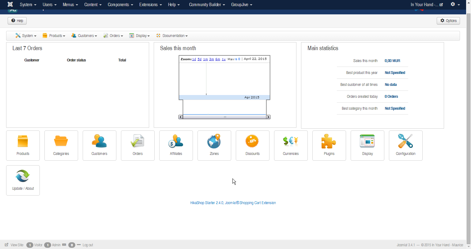

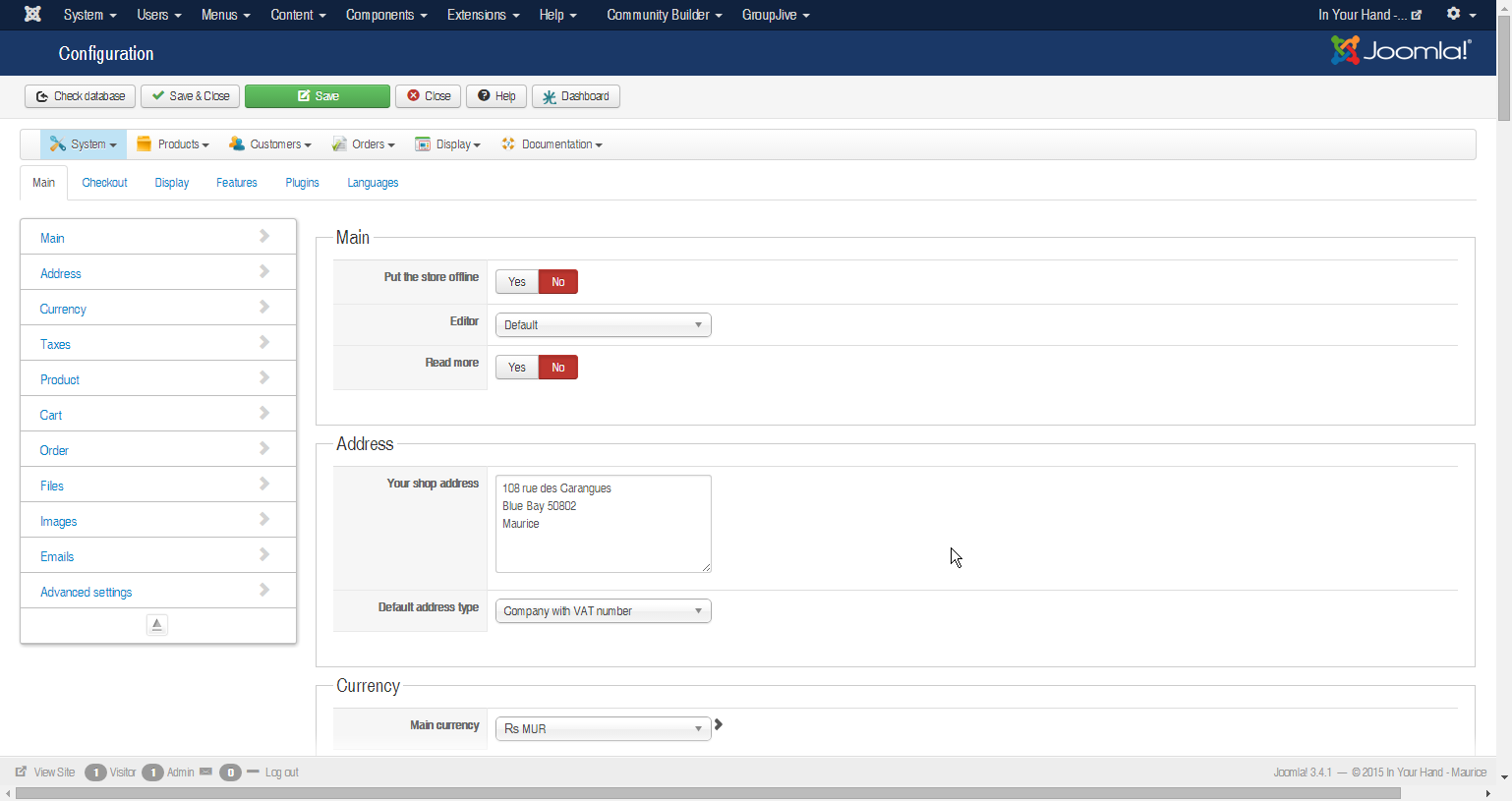

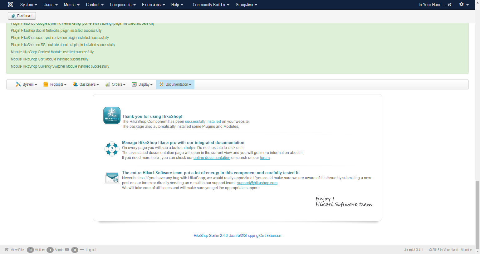

thank you for your reply. So I have uninstall CB Hihashop plugin and Hikashop component from Joomla. I have installed it again successfully (see attachment) from the following zip file (com_hikashop_starter_v2.4.0_2015-04-17_17-28-46.zip). After that, I have checked that I can at least go to Hikashop Control panel and I have changed some basic information in Configuration. All the things are right. Next, I have enabled and displayed the CB plugin on user profile but the problem is still occuring. So I decided to check if the helper.php file exists on the system.
