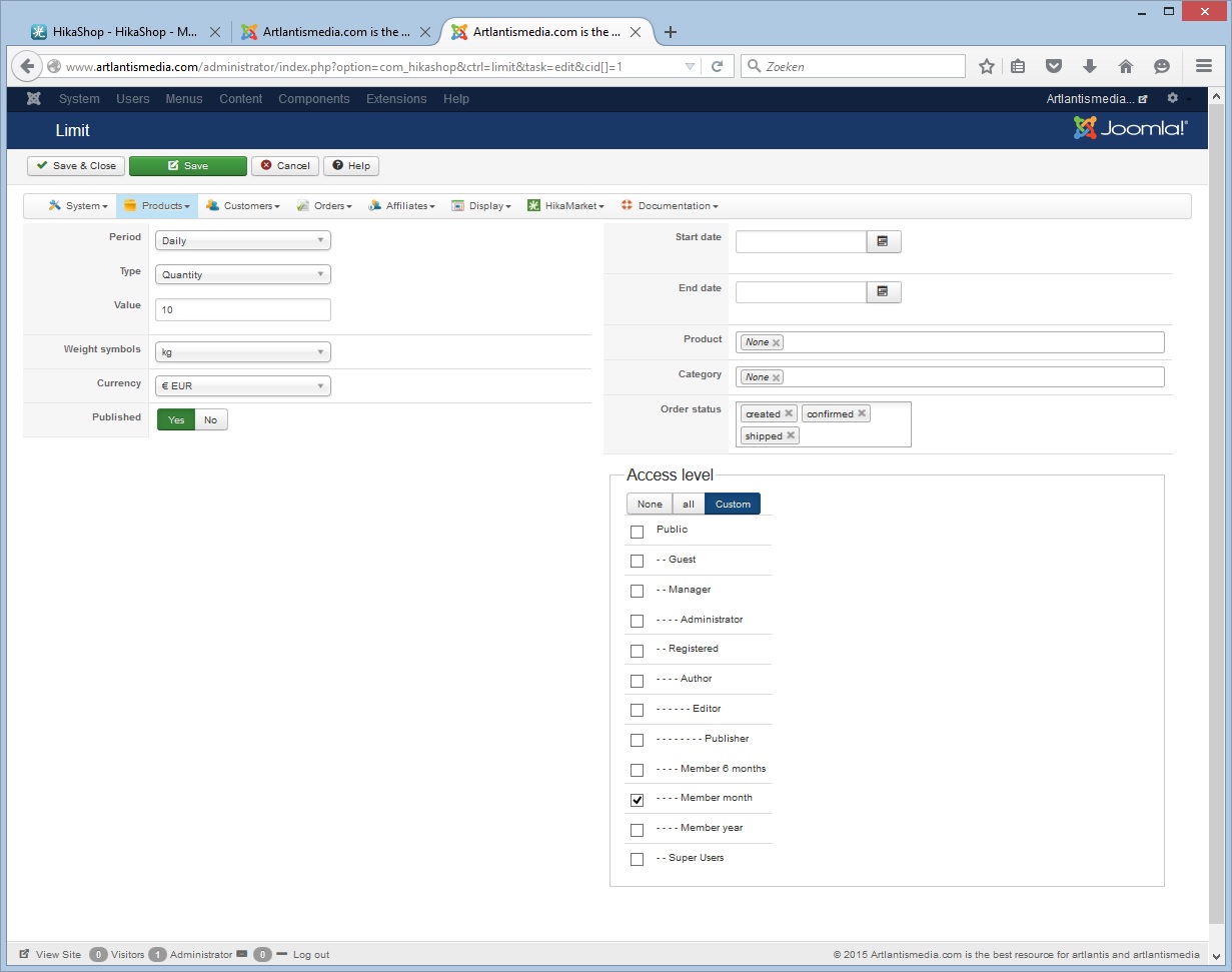

I tried to create a limit. Screenshot attached. A one month member may purchase/download 10 products per day.
With a monthly member testaccount I tried to create an order that contained more then 10 products. The order was created without a problem. All products could be purchased. So it seems the limits are not working. Or am I doing something wrong?

11 years 1 month ago #207476
I just done a local test and the limits seems to be working as expected.
Are you sure that the account used for the tests was in the group "Member months" ?
Regarding the filter, the easiest way will be to create a new category named for example "free products" and add this category to the desired products and finally add the category in the settings of the limit.

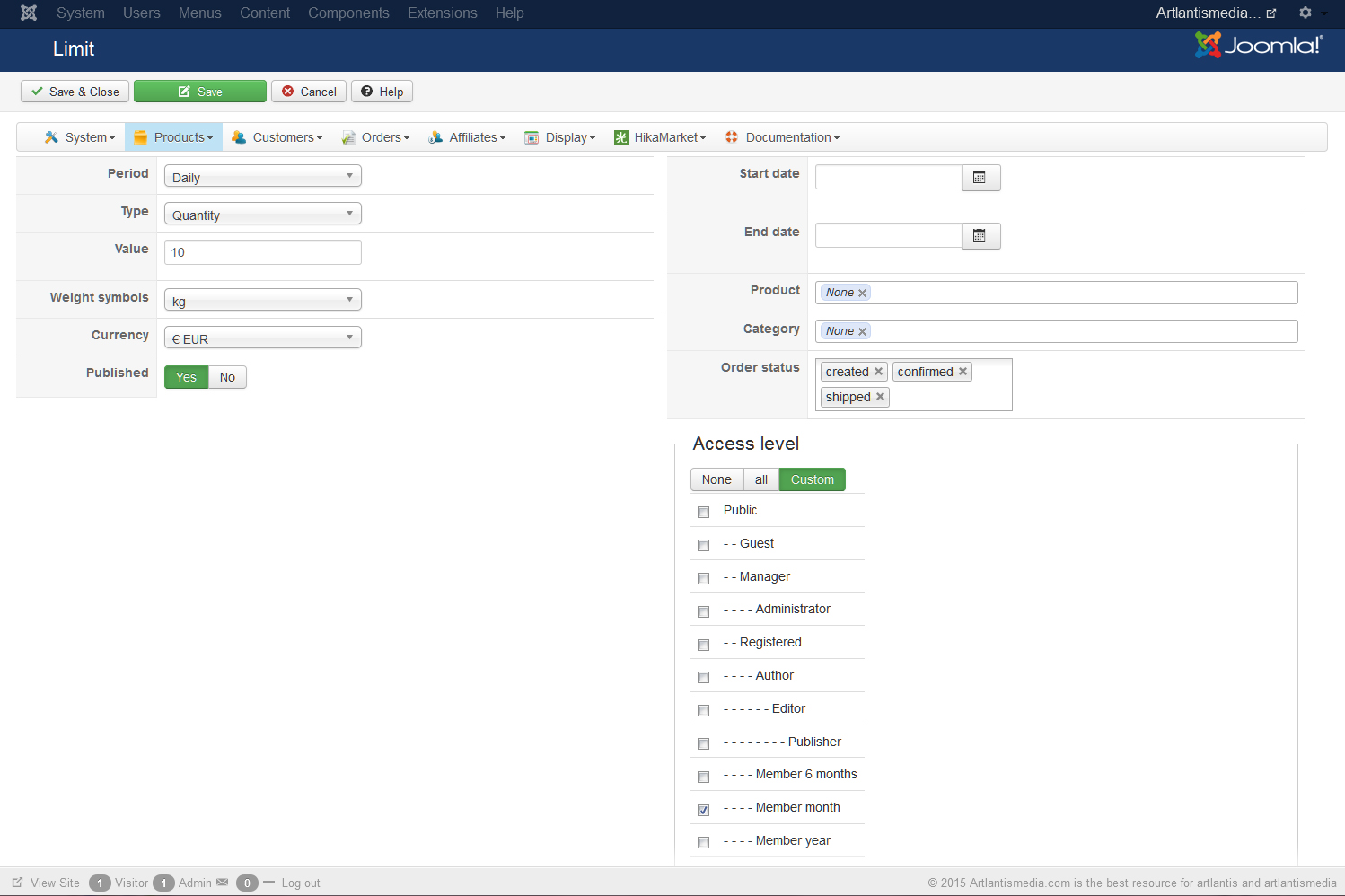

10 years 10 months ago #216552
limits do not work. I still have members ordering many more free products per day then they are entitlled to.
Can this be solved?
Attached a screenshot of settings. Do I have my settings right?
Sjaak

  • Posts: 86042
  • Thank you received: 14175
10 years 10 months ago #216579
The settings look right and we don't have the problem you're describing since adding the patch above.
So we would need a backend and FTP access to your website, along with precise instructions to easily reproduce the problem on your website in order to debug the problem on your website.
