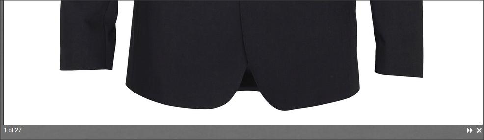

1. I go to a product page that has 3 images on product level. The product has 3x3 characteristics = 9 variants
2. Without hovering over any of the thumbnails, I click on the main image to show Shadowbox. The caption says "1 of 27"

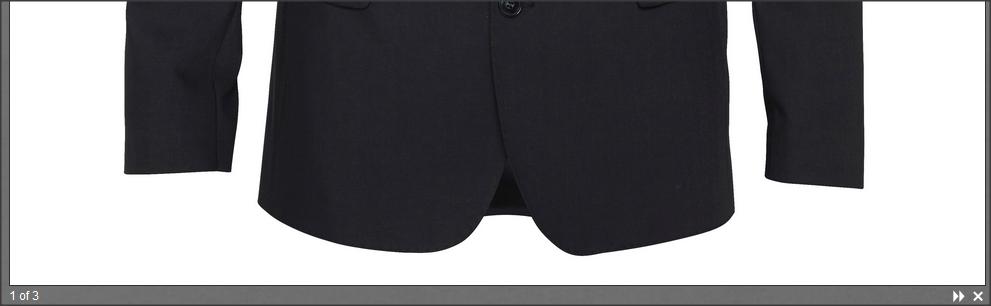

3. Click out of the shadowbox and hover over any of the thumbnails
4. Click on main image again and the caption now says "1 of 3"
The "27" seems to come from 3 images x 9 variants. How do I fix this?
I am pretty sure the Shadowbox is picking up the hidden divs that contain the remaining 24 images

This is a known issue. We didn't find a correct solution to it to work in all cases.
As a fix, and supposing that all your variant images are the same, you can remove the code:
$this->setLayout('show_block_img');
echo $this->loadTemplate();
from the file "show" of the view "product" to remove the hidden images of variants so the images won't change when you change the variants selection.
Another solution is to not use shadowbox but the default image popup display.
