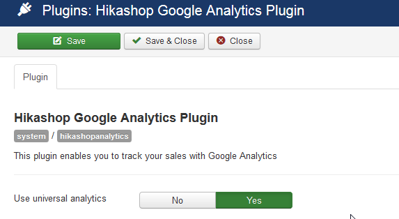

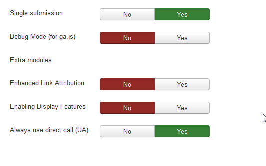

Attached are the settings for the plugin:
