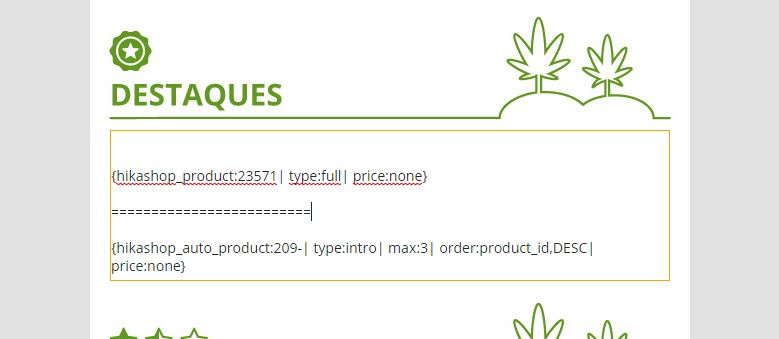

I use the integration with acymailing to create auto newsletters and i've a few problems:
- custom template don't works, i checked and i've the correct hikashop_product.php file but the newsletter show the standard template;
- the tag generator don't works correctly because for example i use the tag {hikashop_auto_product:209-| type:intro| min:1| max:5| order:product_id,DESC| filter:modify| price:none} and the newsletter created show the price.

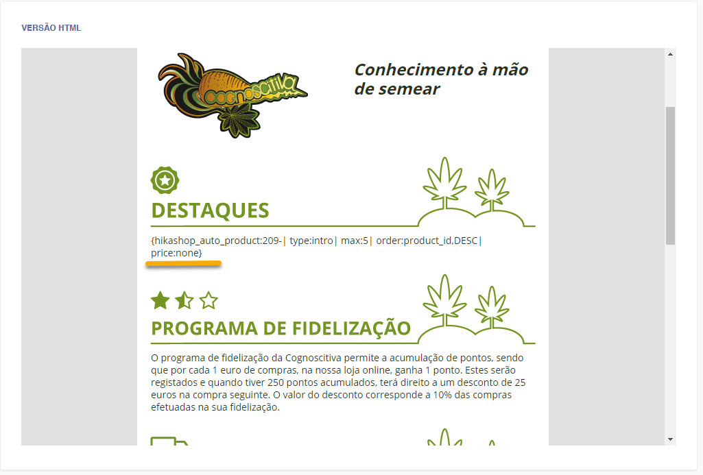

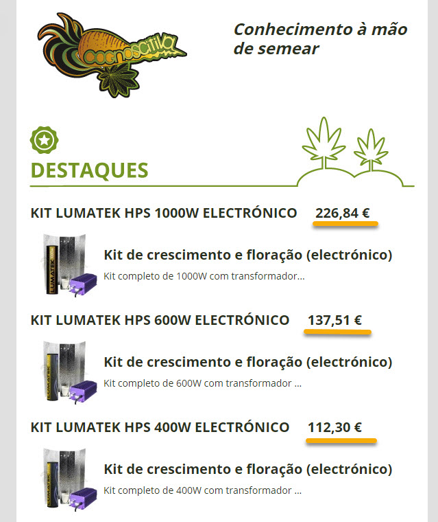

And the second question: why even setting to not show the price in the plugin, the price is showed? As you can see in the print screen, in the tag the "price:none" but after in the newsletter the price is showed.

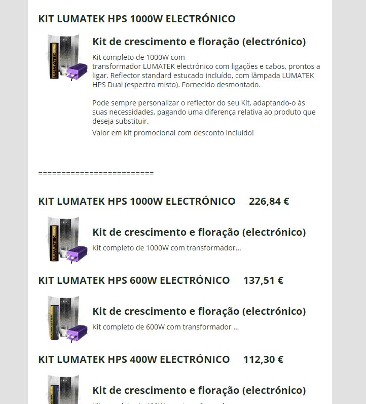

8 years 5 months ago #288839
In custom template, if i remove the {finalPrice} tag the price is not shown.
Yes, i'm using auto tags for smart newsletters - is very useful in my case.
With normal tags, if is a product tag with price set to none works fine. If is a category tag (for example to put some product of same category) the price set to none don't works (the price is shown). So, the problem is with category tags.

  • Posts: 86042
  • Thank you received: 14174
8 years 5 months ago #288841
Thanks for the additional details.
Add the line:
						if(!empty($parameter->price)) $args[] = 'price:'.$parameter->price;
after the line:
						if(!empty($parameter->lang)) $args[] = 'lang:'.$parameter->lang;
in the file plugins/acymailing/hikashop/hikashop.php and that will allow the system to handle the price setting in the auto (smart) newsletters.
We'll add that patch on our end too.
