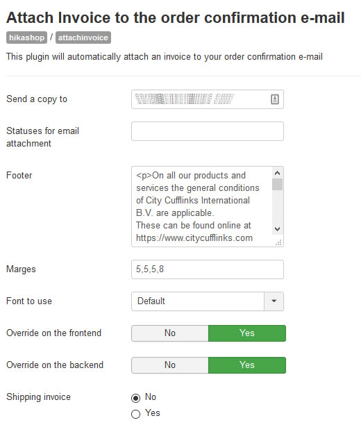

I installed attach invoice and everything works very well.
Only the PDF is NOT send to admin, while his email is filled in plugin.
Any idea what I can do to solve this?
I'll keep on trying!

  • Posts: 66
7 years 6 months ago #302715
Hello
I have the same problem. The customer receives the e-mail with PDF. The admin does not get a PDF.
Have tested different e-mail addresses.
Only the customer gets a PDF.
If I pay, the plugin should work as it should.

  • Posts: 66
7 years 6 months ago #302738
Yes, I get as an admin an e-mail, but without PDF. Have the admin address in the plugin "send a copy to" and now synonymous with system -> emails as BCC.
Still the same problem. Have tried it already with other e-mail addresses. Only the customer gets a PDF.
