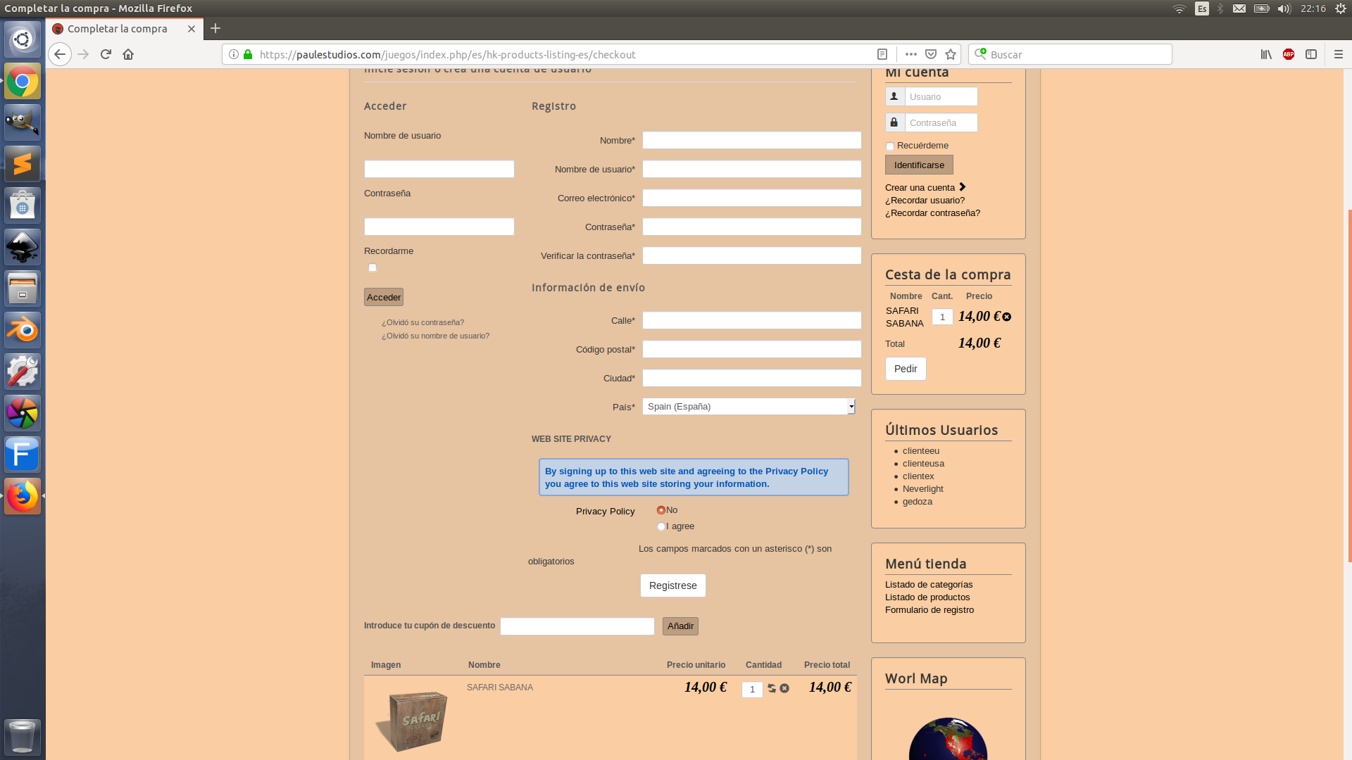

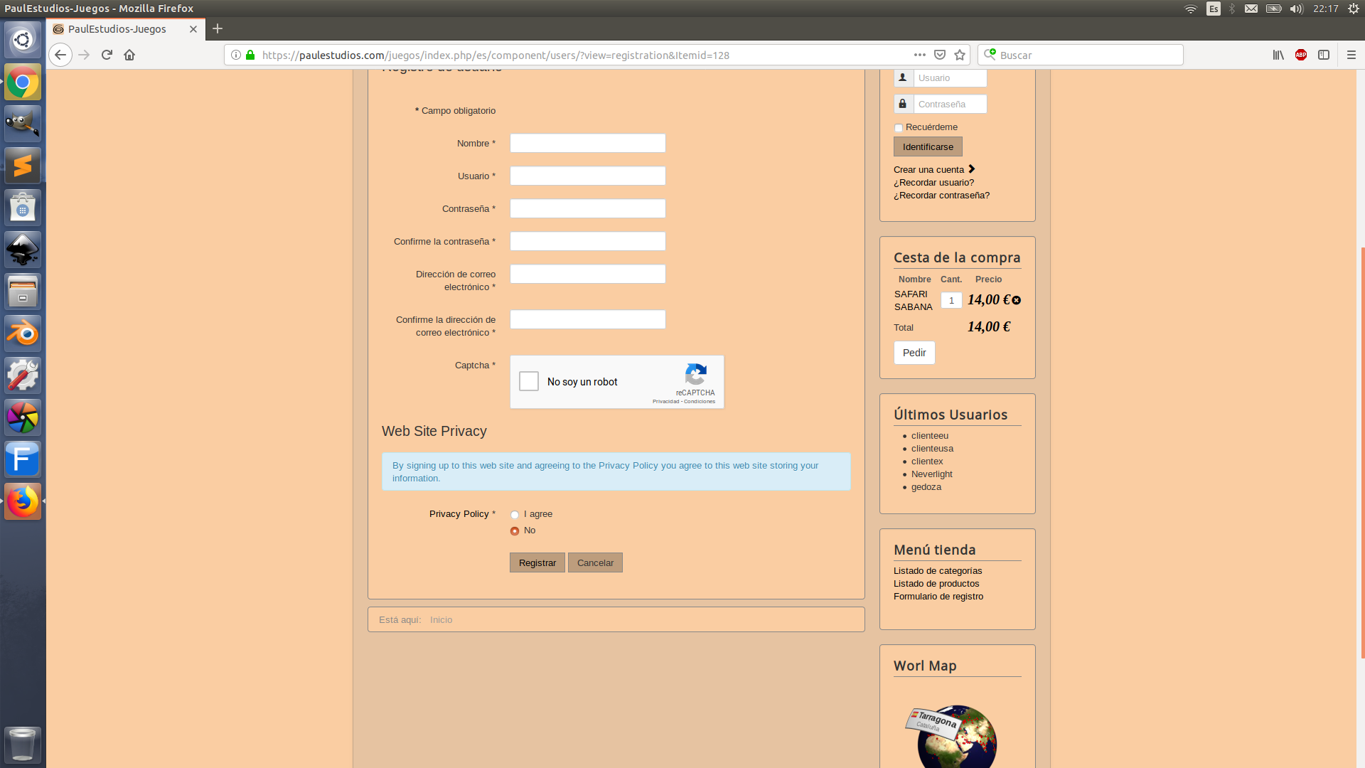

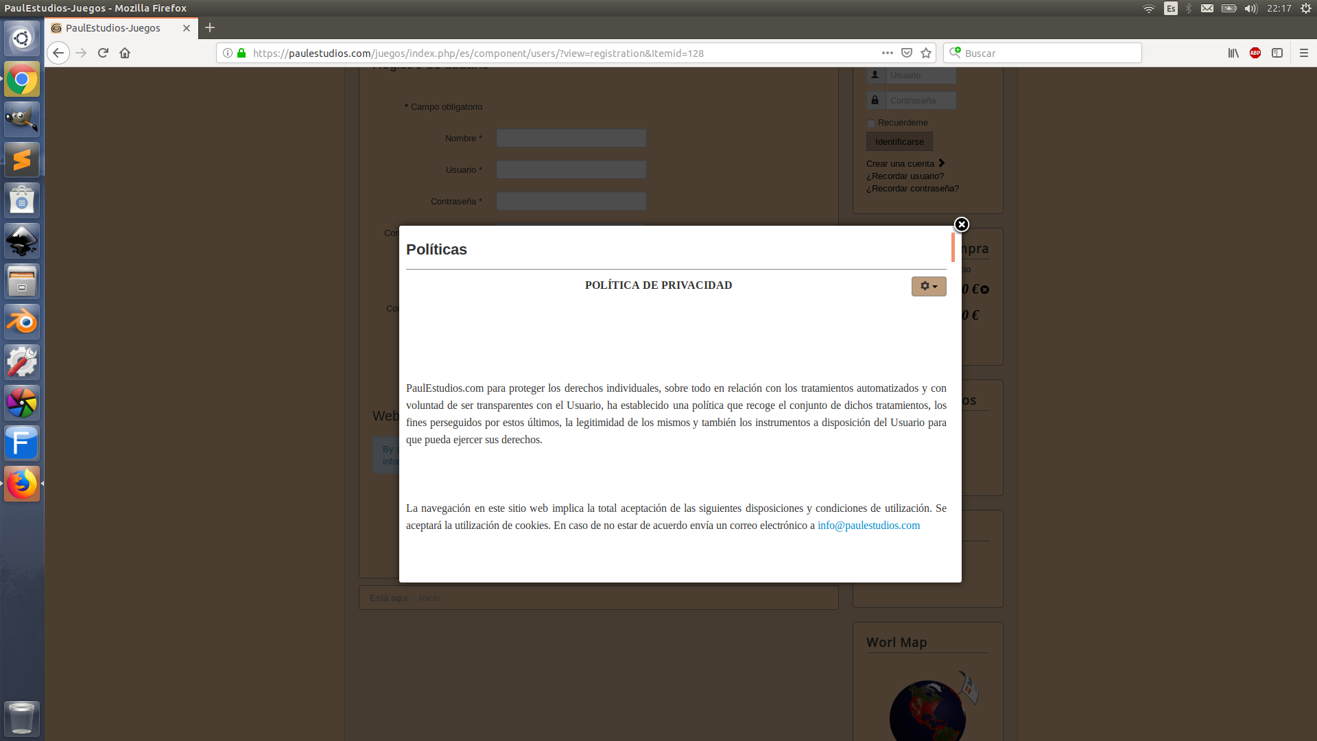

Hi all, I am new on this forum, I have recently updated all my site, joomla, and hikashop and set up the consent privacy plugging in joomla that works very well on the joomla registration form see attached, but in hikashop appears as not required and fail to link with the privacy policy article.
what could be?

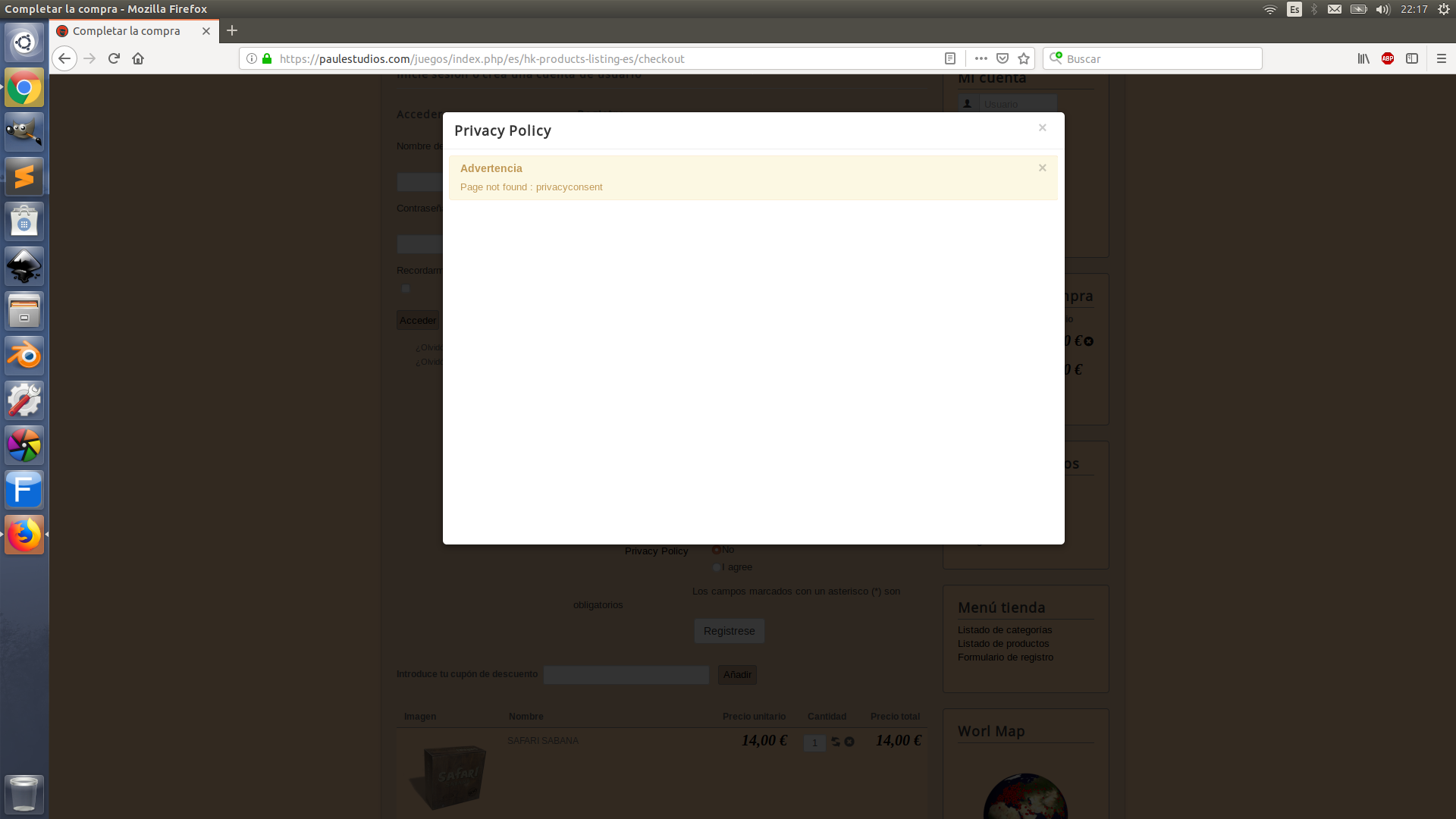

This looks like a SEF routing issue.
I tried to reproduce the issue but I'm not able to. I'm not able to get the URL of the popup to be similar to what you have on your end.

Hi, you just need to try to purchase something, is simple, and the hikashop registration form will display, no need to access to the backend, just try to purchase, Ii is very simple, I have tried in several browsers and different pc and still the same issue.

No, I understand that, and I'm able to reproduce the issue on your website, but I'm not able to reproduce the issue on my local website as I don't know how your HikaShop, menu items, SEF are configured on your website.
And that's why I would need the access to be able to look at all that.
So I would still need what I requested before to be able to help you as I don't know why you have that problem.
