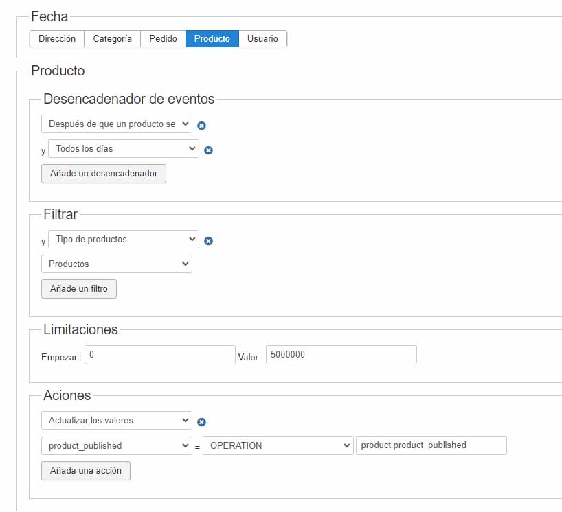

  • Posts: 267
  • Thank you received: 5
4 years 11 months ago #335932
Hello Nicolas,
Thanks for your answer, I have performed the following massaction.
But the quantities of the main product, which should be converted into the sum of the stock of the variants, remains at zero.
I do not understand what is the mistake I am making.
You can help?
Last edit: 4 years 11 months ago by dvddvd.
  • Posts: 86089
  • Thank you received: 14195
4 years 11 months ago #335939
That's my bad. I thought that the save of class.product was called when an action was called, but looking at the code that's actually not the case for mass actions on products, due to performance issues.
So instead, you need to use a mass action with a action "Run PHP code" and use that code:
$class = hikashop_get('class.product');
$product = new stdClass();
$product->product_id = {product_id};
$class->saveRaw($product);
The following user(s) said Thank You: dvddvd
