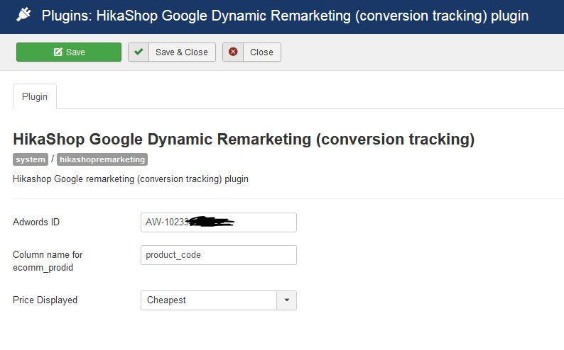

Hi, I'm struggling to find a working solution to this both in your documentation and on the forum. I've recently signed up to google ads and I'd like to track the number of conversions (sales).
I've edited the file after_end.php with the following code (ads account changed) as advised on google ads;

and b) what does the plugin - HikaShop Google Dynamic Remarketing (conversion tracking) actually do?
  • Posts: 86114
  • Thank you received: 14210
5 years 9 months ago #326463
1. It depends on the payment method you're using. It could have to be done in the "end.php" view file for some payment methods like authorize.net in AIM mode.
However, in the large majority of payment methods, it's indeed after_end.php where you want to add your code.
2. This plugin allows to link the adwords and the display of product details pages:
support.google.com/google-ads/answer/2476688?hl=en
It's different than linking sales to adwords like you're trying to do.
