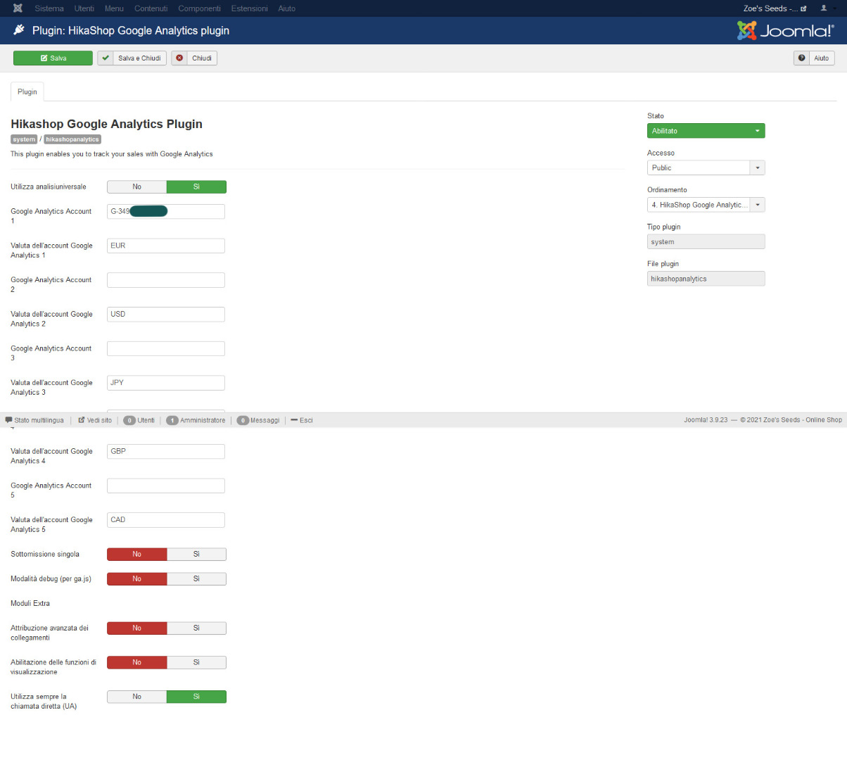

5 years 6 months ago #328557
Attached the plugin configuration.
The Id is changed and now it links to the stream measurement ID.
If I put the Account ID (that isn't prefixed with UA anymore) I'm still not able to fire the event.

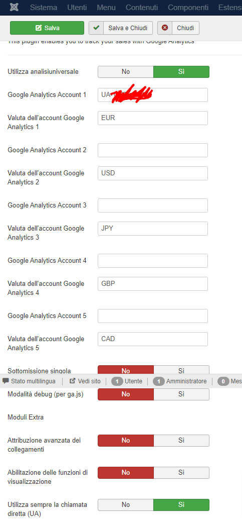

I'm try to implement your plugin. What I've done
- Activated a UA property wit standard e-commerce enabled
- Created a Tag with GTM that fires when user reach confirm page

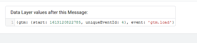

Question: is the confirm page the page where the plugin send the Data Layer to GA?
Below the plugin config and the data layer shown by GTM
Thanx
