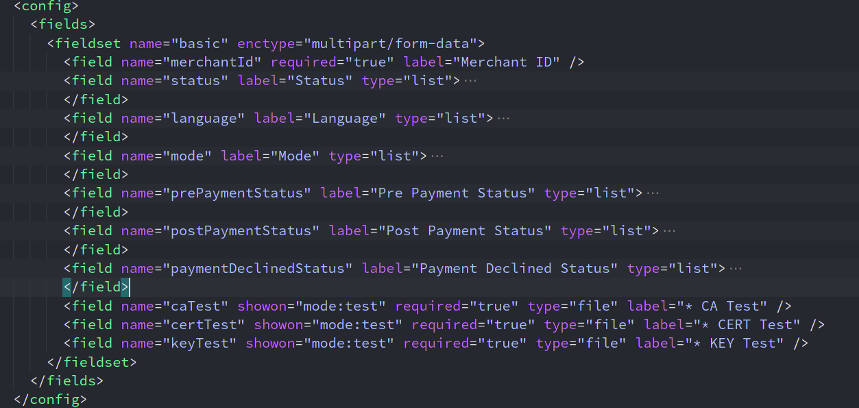

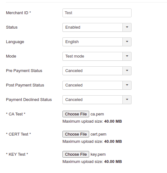

5 years 5 months ago #329987
Hi.
I'm trying to make a payment plugin, this plugin has some custom fields I added manually in example.xml file.
Here is code how I added.
How it displays:
So far, everything is fine.
My problem is with last 3 fields, I can't accessing them correctly.
Access to the fields above them works perfectly, but with files it doesn't.
I am trying the code You provided like this:
$plugin = JPluginHelper::getPlugin('hikashoppayment', 'example');
$this->params = new JRegistry(@$plugin->params);
echo $this->params->get('caTest');
This shows me only the name of the file I entered.
The question is how can i get the entire file added there? I need the file and its content inside to make request.
Hope I was clear.
Regards.
Last edit: 5 years 5 months ago by lirimimeri.
  • Posts: 86042
  • Thank you received: 14174
5 years 5 months ago #329996
It's normal you only get the file name with this.
You need to prepend the path of the folder where the file is uploaded.
Now I don't know where Joomla put the files uploaded with that type.
And it's not mentioned here:
docs.joomla.org/File_form_field_type
I would recommend to ask this on forum.joomla.org
Also, I would recommend to have these files in a folder not accessible by a URL. Otherwise, anyone would be able to download these files and they might be able to impersonate the merchant on their own website, or validate orders without any payment made.
The following user(s) said Thank You: lirimimeri
