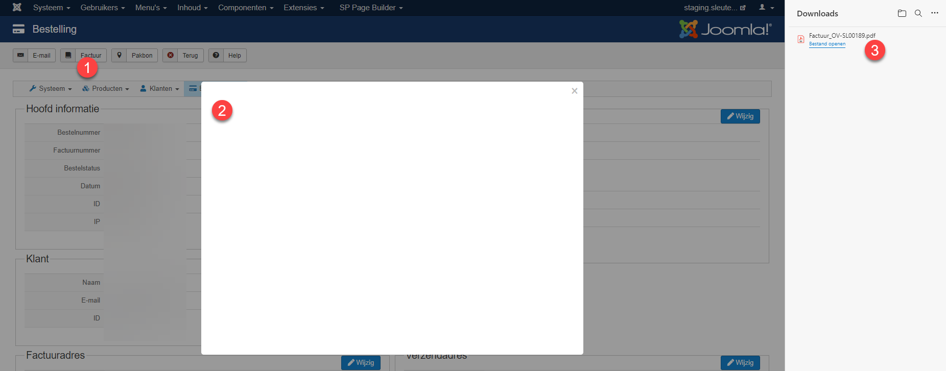

I use already a long thime the attach invpoice plugin that generate pdf invoives and addn them to an email. That is working fine.
One thing is a little strange. HWe I got to orders and want to generate an order manualy, it is genarting the invoice (it's downloading to my computer) wich in fine, but after download the popup screen stays empty. It would be nice if there was a message telling download went fine or the popup don't need to show up.
IS this the behavoir of the plugin or did I do something wrong?
See image for extra explanation.
1: Press on th button onvoce
2. The popup appears
3. file has been downloaded.
The screen stays empty.
