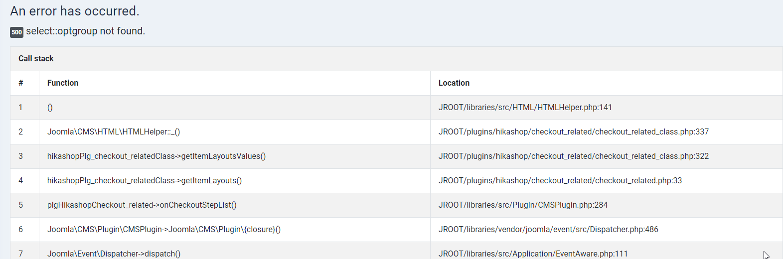

After upgrading to from J3 -> J4, I noticed many php errors when trying to access the HikaShop configuration. I was able to isolate it to just the checkout related plugin.
select::optgroup not found.
Please let me know if you need any additional information or backend credentials.

Please re-download the plugin in order to have the fix.
We fixed that issue several months ago but it looks like we had an issue with the upload of the latest version.

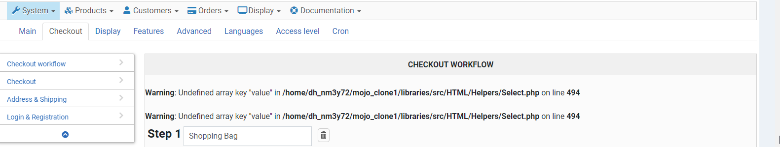

Thanks Jerome! After installing new version, i no longer get the 500 errors. However, i did see a php warning come up that i can toggle with the checkout related plugin being published:
Warning: Undefined array key "value" in ****/libraries/src/HTML/Helpers/Select.php on line 494

The warnings are showing up "Configuration -> Checkout -> Checkout Configuration"
I'm assuming it's something specific to the checkout related step panels.

  • Posts: 26381
3 years 3 months ago #351286
Thank you for the screenshot.
There is indeed an issue with the HikaShop core which cannot handle "groupedlist" content with Joomla 4.
One possibility is to modify the file "checkout_related_class.php" in order to replace the content
	$values[] = array(
		'text' => $optGroup,
		'items' => $ret
By
	$values[] = $ret;
But you'll loose the "template" detail in Joomla 4.
The other possibility is to fix the HikaShop core in order to handle groupedlist for J4 ; or to add a new type of content specially for grouped lists.
