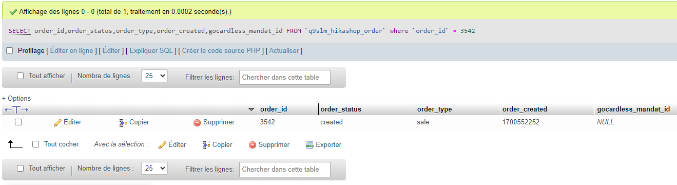

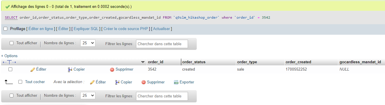

I went directly in phpMyAdmin to verify the content of the order (in case some back-end functions) may change the DB values.... And the corresponding columns are "NULL"...

As expected, the order->save has been triggered once more and the object content was displayed again before the final exit.
In this situation, the order object shown has the customfields to "null" including the "old" object one.
So it really looks like the first update which trigger the parent::save in the order class does not actually save in DB the custom fields values.
By the way I have also disabled all the plugins who may interfer with the process (onBeforeUpdate). But since the values are there before and after the "parent::save", I suspect something happens during this parent's save function.
Where is made the actual save ? May you have an idea on where it could come from ? Some other hints ?
Laurent

Here is the result of the query in phpmyadmin :
just after the parent::save(), all the three "go_cardless_xxxx" custom fields are set to null. None contain the right value...
