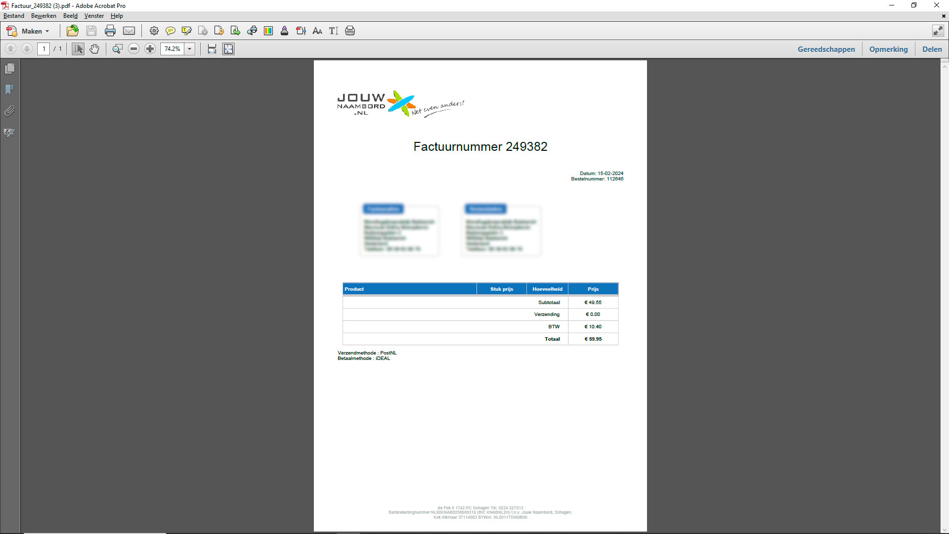

Since the latest update to 5.0.3 sometimes (not always) the pdf invoice doesn't show the product(s) of the order. See screenshot.
I think it only applies to orders where a product is added or changed in the backend.

Everything looks fine to me with the data of the order from what I can see in your backend.
To me, it looks like a customization issue in the invoice template file of the PDF invoice plugin.
I would need a FTP access in order to check the situation in there.
  • Posts: 86042
  • Thank you received: 14174
2 years 5 months ago #359136
Thanks. I've looked into it. The problem is that on this order with the invoice id 249382, you have only one product, and this product is an option of another product which has been deleted from the order.
Also, since you have the "group options with product" setting activated in the HikaShop configuration, options are displayed together with their main product, with their name below the name of the main product in the row of the main product.
So it's actually normal that the invoice of this order doesn't display any product.
This has nothing to do with the update to HikaShop 5.0.3. You would have had the same behavior with any version of HikaShop in the past.
It seems that the problem is caused by something changing with how you're using HikaShop on your end.
Now, the question is why you deleted the main product without deleting its option too ?
