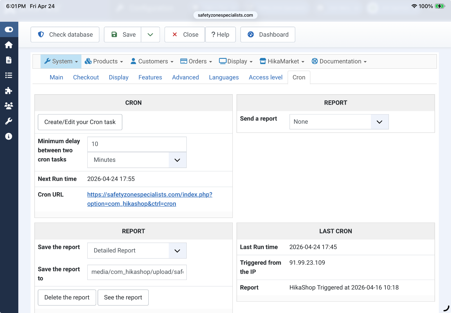

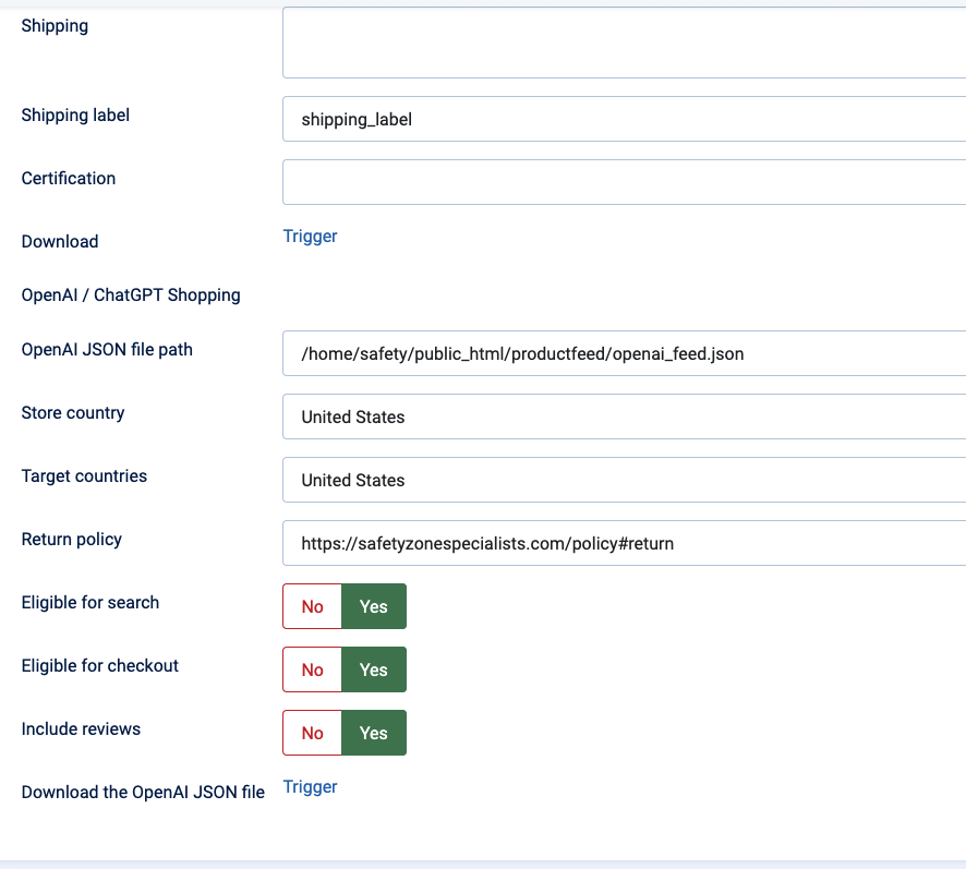

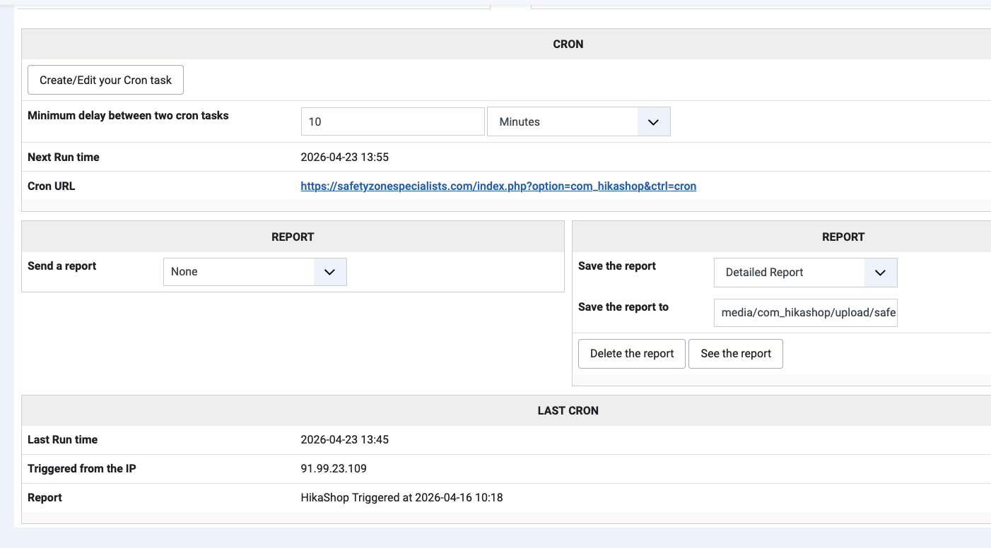

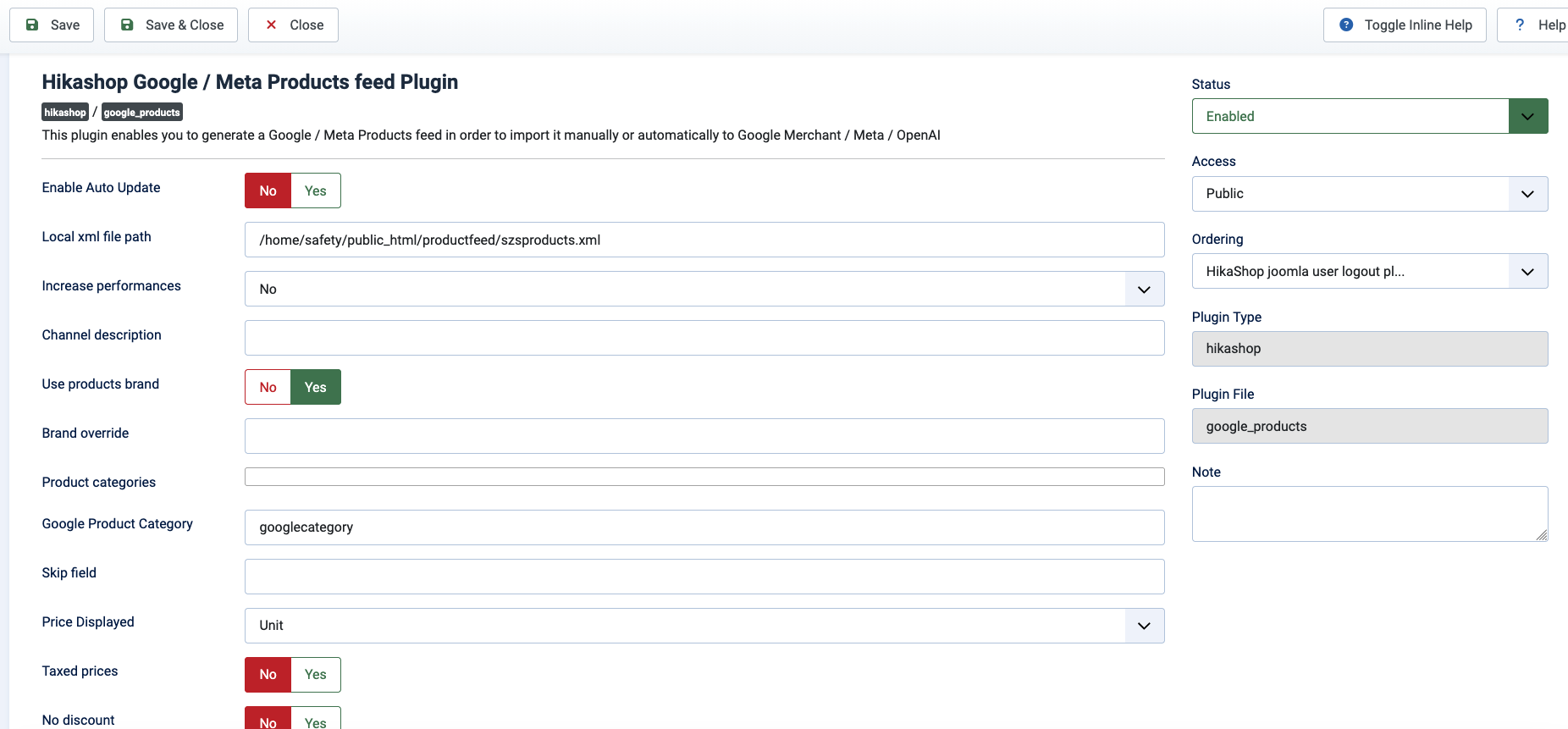

Greetiing,
As the title notes. My Google Products Plugin is not updating the associated xml and json files when the cron job is fired.
- The files are generated when I use the manual trigger
- I'm using an outside cron service. The Hikashop configuration cron page is verifying the cron is firing.
- I had this working on another server. I suspect it has never worked on my new server. Figured that out when I went in to enable the new JSON feature.
Attached find screenshots of the Hika cron config page and a couple shots of plugin settings.
I've set the sever folder and files to 755 permissions.
I;ve shut off Admin Tools and got the same results.
I've had Claude review my admin tool generated .htaccess and it found and fixed one problem.
Got any ideas ?

4 months 4 weeks ago #371651
If you want the plugin to update periodically the XML / JSON, you need to activate the "Enable auto update" setting.

4 months 4 weeks ago #371654
tried with autoupdate enabled.
still didn't update files.

4 months 4 weeks ago #371658
Thanks nic,
See attached.
Crons are sent from an external service every 15 minutes using the specified url.
Hikashop sees them as noted on the cron page.
Hikashop frequency is set to 10 minutes.
Hikashop reports only register when I’ve triggered manually.
: D
