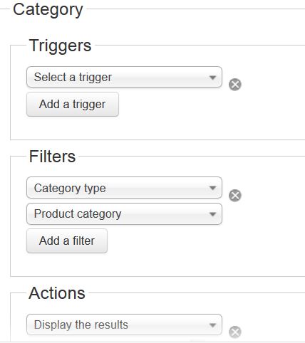

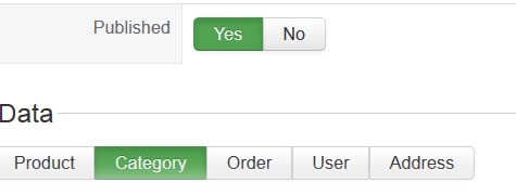

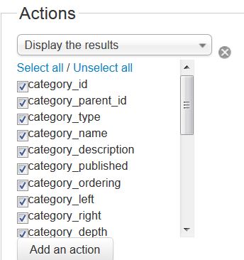

Can you do a screenshot of your massaction ?
  • Posts: 223
12 years 11 months ago #119247

Do you have the HikShop mass action category plugin activated on your website ?
The following user(s) said Thank You: plumbingdeals
  • Posts: 223
12 years 11 months ago #119340
Yes, that was it...these system plugin activated, but the category, products, etc...we're not
Working fine now
