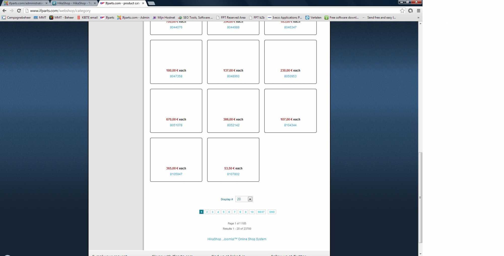

I have been testing with importing articles, but some are incorrect.
To start over I would like to delete all.
I have been informed that I can use Mass action and delete category for category.
But I am unable to find out how it works, can you help?
See attachment for the settings I have tried:
Last edit: 12 years 11 months ago by info@ifparts.com.

  • Posts: 45
12 years 11 months ago #120262
I felt stupid after reading your message, and happy because I thought I found the solution.
But it still does not work.
I have tried a few different options, but without reslut, see attachment

  • Posts: 45
12 years 11 months ago #120463
Hello Eliot,
Please see second print screen in the zip file of my previous post.
I have also tried with, selecting product. I have writen the number of a category in the filter.
