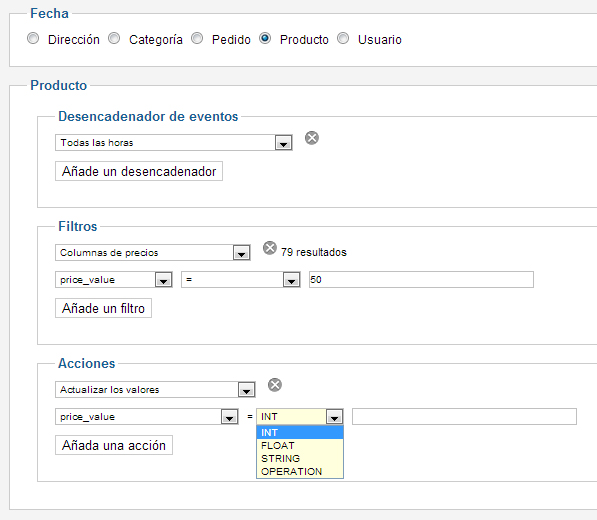

Hi! Im trying to simple change the price of all products for another one. But i cant make it work, i dont know if im doing something wrong, just need a little step by step, thank you so much in advance!
  • Posts: 85982
  • Thank you received: 14148
12 years 7 months ago #135542
You set a filter so that the mass action only affect the products with a price of 50.
So you probably don't want any filter and only an action with a price of 50 set so that it updates the value of all the products.

12 years 7 months ago #135550
Yes of course, i want to change only de products that cost 50, but then... i dont understand the options (INT, FLOAT, STRING, OPERATION) i even tried with each one, but nothing happened.
What i want to do, is simple change 50 to 114
Thank you so much in advance and for your patient!

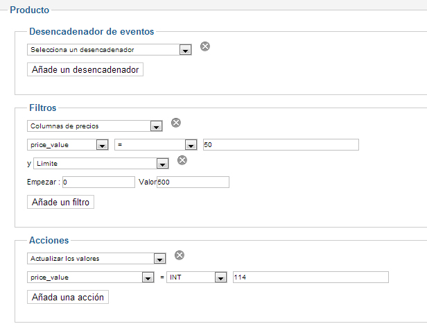

12 years 7 months ago #135586
Then you need to keep the filter on 50 and in your action select INT and enter 114.
Also, add a second filter on "limit" and make sure that you increase the limit as otherwise, it will only apply to the first 500 products costing 50.
Once you're set, you can click on "process" in order to run the mass action and change the price.

12 years 7 months ago #135619
Nothing happened... im sure im missing something...
