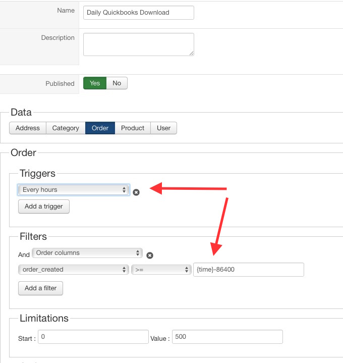

I must be doing something wrong and I am also getting an error message. So, let me take you through step by step so you can figure out what I am doing wrong:
Mass Actions:
• I set the mass action to hourly for testing purposes. See mass actions.jpg

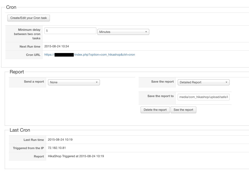

cron

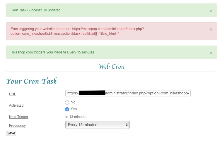

• I have set cron to the quickest frequency which is every 15 minutes. When I save this setting, I get an error that I do not understand. See cron setup page 2.
• The first page I see when I go to your cron page is set up as shown in cron page 1.
Please let me know what I am doing wrong.

10 years 9 months ago #218519
If the action is not launched, so this seems to be due to the cron error you have.
Is the url in the cron settings the one attached to your account on our website ?
hikashop.com/my-account/your-subscriptions.html
Please check if it is set in "http" or "https".
www.hikashop.com/support/support/documen...ashop-cron-task.html

10 years 9 months ago #218637
You are correct. The subscription in my Hikashop account shows as "http:" I have tried several times to change it to "https:". But, it always reverts back to "http:"

Please give me the name of the action having the issue, I will do a complete debug on your website.
For the moment, I think that the file is not generated so nothing in the email because there is no data get.
No elements to export, so if there is no elements, no reason to create the file.
Now, the question is, why it does not get any elements ? maybe due to the filter based on the {time}...
