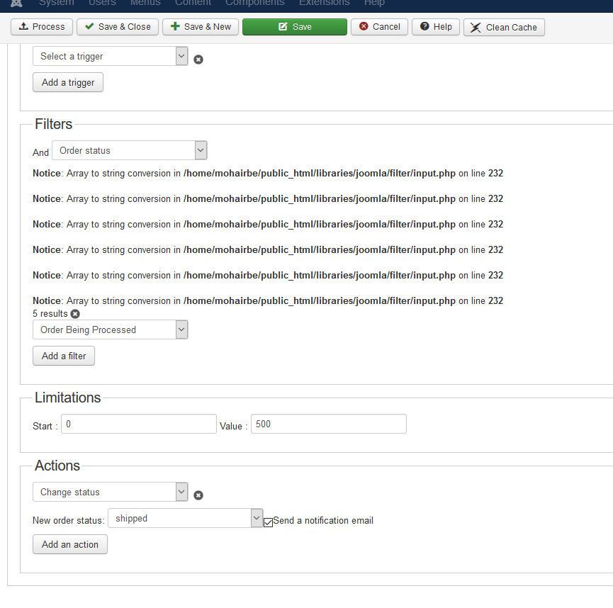

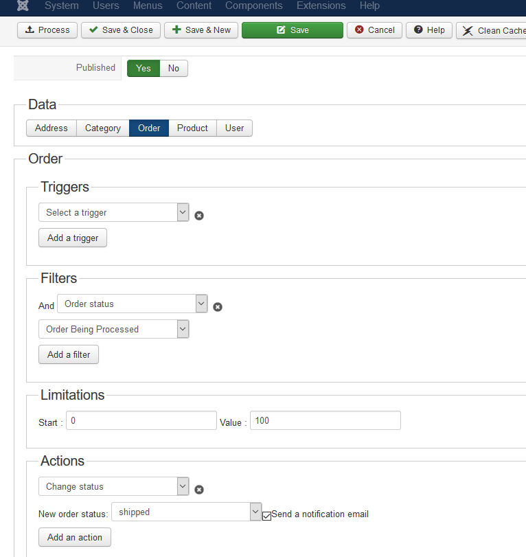

Hi I have been using a mass action for quite a while now and for the last 2 days it has stopped working? when applying the action the page just goes blank and hangs? see below my configuration

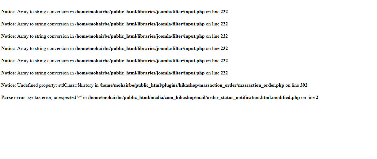

Hi Orders are never greater than 20 at a time. Here are 2 screen dumps of the errors.

The error message says that you've modified the html version of the order status notification email incorrectly and broke it. So when the system tries to send the email, it crashes.
Fix your modifications there or remove the customization of that email and it will work.
