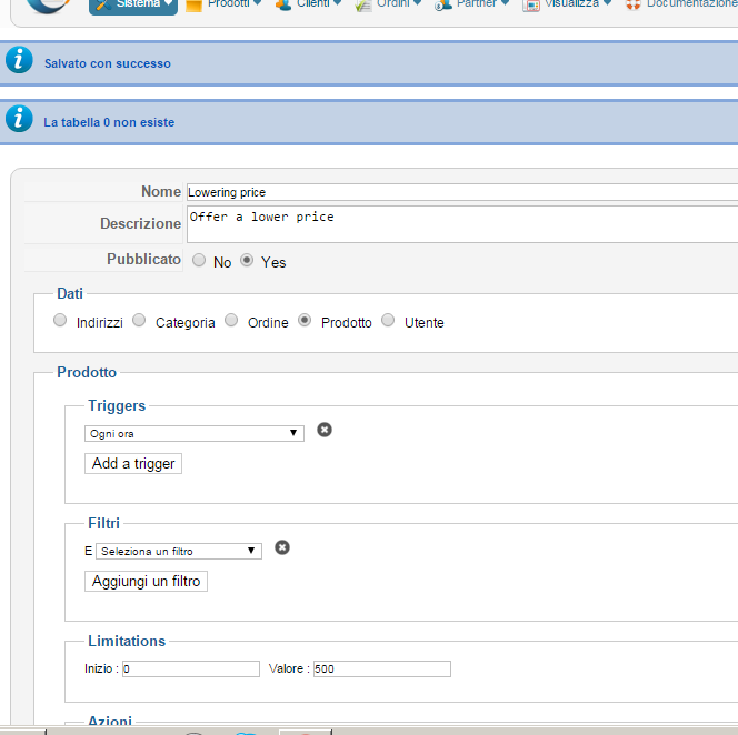

I was running an hourly mass action on price_value
the price of all products (3 products)was getting lower by a fixed amount
After having done the update from 2.5 to 2.6.0 the action stopped working
information message is attached
It seems tab 0 was missed
Pease how can solve this issue ?

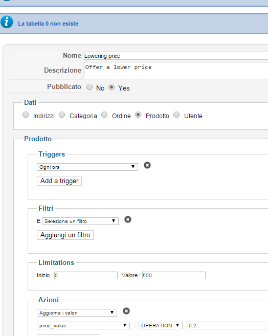

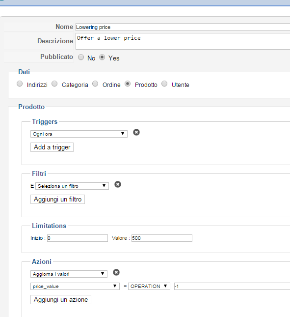

I have cheched ...... and with integers the action works ..... and it does not work with decimal numbers
Best regards GG
10 years 9 months ago #218581
Please try to use that string: "price.price_value-0.2" instead of "-0.2".

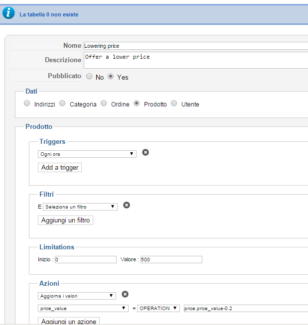

10 years 9 months ago #218627
I have tried but it still fails working.

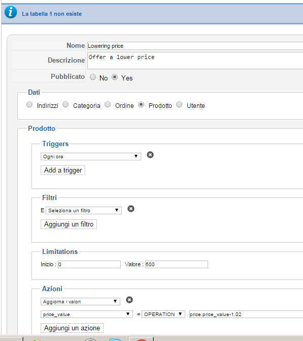

Please take a look at the second attached file .......I used a modified string just to make try with a value > 1
The information comes the same but tab is 1 .......
