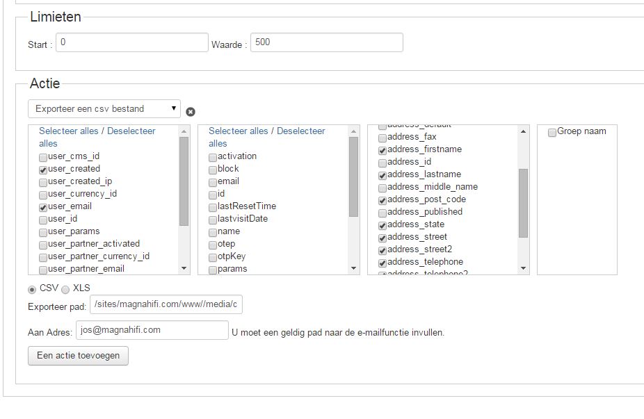

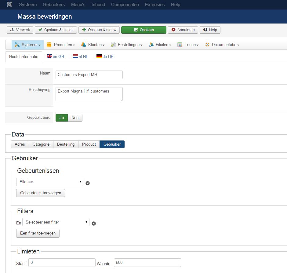

How did you configure your mass action (please provide a screenshot of its settings) and what are you trying to do with it ?

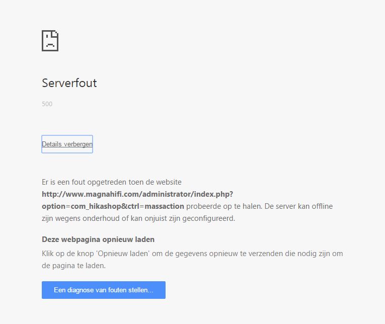

Strange indeed. We run this export every month. I end up with an error message: Server error 500 (Not 900)
I have no clue, no changes in the export configurations were done.

I think that the issue come from the double "/" present in the url of the path of your file. If not, so:
Do you have this error if you click on the "Verwerk" button ?
If you reduce the quantity of elements to be treated in the "Waarde" field, do you still have an error ?

Could you try to remove this part in your csv path:
/sites/magnahifi.com/www/
