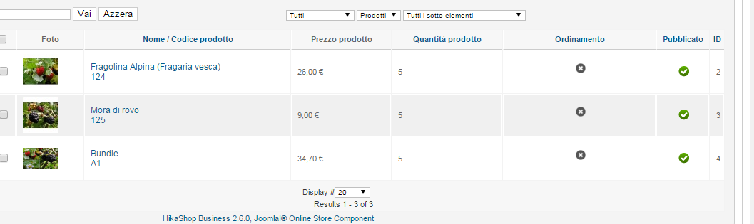

It may seems that my questions are stupid and really they are but please confirm that I am correct
I do not need more than one category and for this reason I have my all ( 3 ) products ..... in product category
1) to filter the single product I have assumed to refers to id number .... in my case 2-3-4
the question is : which is the difference between the use of filtering the product by.... price_id or price_product_id
I ask you this question because mass action does not work properly and I am looking for the correct way to filter the products.......
2) Is cron set every 15 set up correct ?
I am not sure that the mass actions works correctly ..... 2 mass actions triggering every hour the price_value that is lowered by a fixed -0.1 ...... more I set up 3 mass actions triggering (every day) which reset the quantities and prices of the 3 products to a fixed value
Consider that if I run the mass action( manually) all works fine .... the issue comes when I save and close the mass action ...... I wait the next day
results do not reproduce in a consistent way ..... sometimes the reset fails
Thanks GG

I have 3 mass actions triggered every day ... each is triggered on 3 different products
2 of 3 are triggered perfectly every day while 1 of 3 does not work at all (for getting it to work I have to run the process manually ... and in this way all is ok)
From what I read all along this thread it seems to me to understand that
A)Every single mass action runs indipendently from the others ..... on my case once a day (trigger is set every day) ....
while in the hikashop_config table I have found that there is a single value for setting the exact time I need ....I mean one configuration value for the time trigger of all the 3 mass actions.
pehaps is there some config time value in others files ? I mean a config time value for each mass actions.
I can't explain to myself why certain(2of3) mass actions runs while (1of3) is not triggered.
I have checked that all the3 mass actions are built with same setting ..... of course each is based to be triggered on different product.
Anyidea ? thanks
Best regards GG
