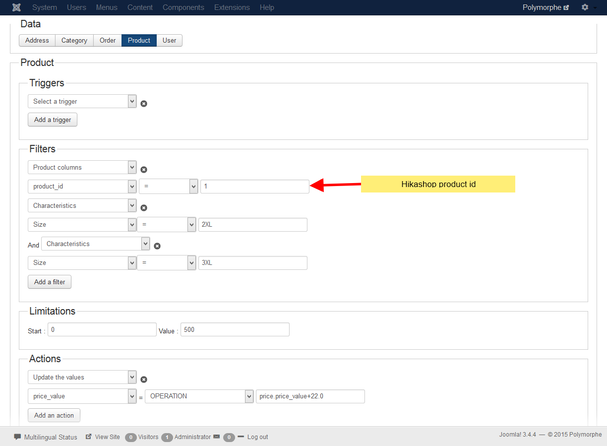

so today I'm trying to change some variants of a single product with Mass actions.
There are many variants, due to many colors that are available (30+).
I have about some 40 colors to choose from in all sizes ( xs, s, m, l , xl, xxl ,xxxl).
So that makes about 245 variants !
Within those variants i need increase the price of all colors with the sizes : xxl & xxxl by 22.00.
c.f: screenshot.
Can you tell me what i'm doing wrong, please?
As it doesn't seem to work.
Thx.

The issue is that you need to select the column product_parent_id and not product_id in your filter so that the system works on the variants and not on the main product.

No, just changing that didn't work, unfortunately...
Jut to explain as simple as possible..
I'm trying to change all the 'color' variants prices for each 2XL and 3XL size by $22.00.
Have any other suggestions??
I'm still trying in the meantime.
As I really need to get this to work, it will save me days of tedious work.

As Nicolas said you have to filter on the "product_parent_id".
Now the issue come from the other filters, now the action try to get the products with the size 2XL and 3XL.
So it is normal that it gets no results, what you need is 2XL or.
But the "or" is not handled by the mass actions, so you have to execute a first action only for 2XL, and then another one on 3XL.

Thank you Xavier !
That did it.
Now I understand... no "or" , got it !
i guess this is solved.
