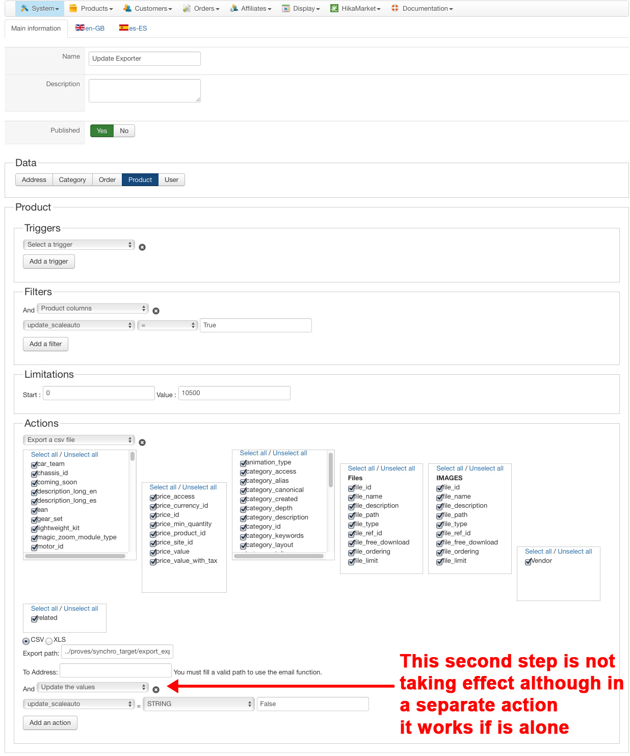

-- Joomla version -- : 3.4.8
I have a batch of actions under a certaing filter. The limitations top Value is much higher than the total number of products.
First action works while second is ignored.
Second action in a separate Mass Action where it stands alone with the same filter works.
I don't get any error message.
Am I missing something in the Mass Action logic?

After further inspection it seems that the second action is working if the first one causes no errors so it gets not aborted.
The problem is that the interface is not informing me if the first one was aborted so I have to manually inspect the first action results to check if the mass action run until the end.

10 years 5 months ago #228783
Thanks Xavier,
I think it was really a bunch of unfortunate circumstances including some browser tabs with the products already in edition status.
After simplifying my test setup I could not reproduce the issue anymore.
Anyhow is good to know this trick of "once the elements are taken from the filters, you can set the actions in any order."
