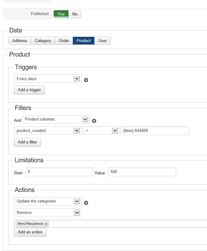

I have mass action where products are removed after 1 week. For some reason products are not removed even I process it manually.
Here is the screenshot of my settings.
Not sure if it is related but I tried to increase value to 5000 and received error:
1064 You have an error in your SQL syntax; check the manual that corresponds to your MariaDB server version for the right syntax to use near '1134,1136,1139,1141,1145,1150,865,863,854,856,858,861,913,911,908,906,903,852,84' at line 1 SQL=DELETE FROM #__hikashop_product_category WHERE category_id IN(164) AND product_id IN(2567,779,765,767,769,762,763,758,760,1434,1251,1249,1247,1243,1245,1241,1438,2552,1429,1239,1201,1203,1205,1207,1209,1211,1212,1213,1215,1217,1219,1221,1223,1225,1227,1229,1231,1233,1235,1237,1065,1066,1067,1068,2553,1424,1420,1199,1197,1195,1182,1183,1184,1185,1187,1189,1191,1193,1180, and SO ON......
Any help would be appreciated.

10 years 3 months ago #237776
In you mass action settings it is better to limit to 500 products per request. Else it will consume too much resources.
That should solve your issue.
Else you can install the attached plugin containing a fix.
Last edit: 10 years 3 months ago by Xavier.
