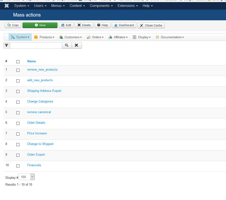

Hi, I use Mass Action on a daily basis and now this morning I cannot get in to any of my saved actions? when I click on the links to get in to the actions it just goes to what is shown in jpg 2?

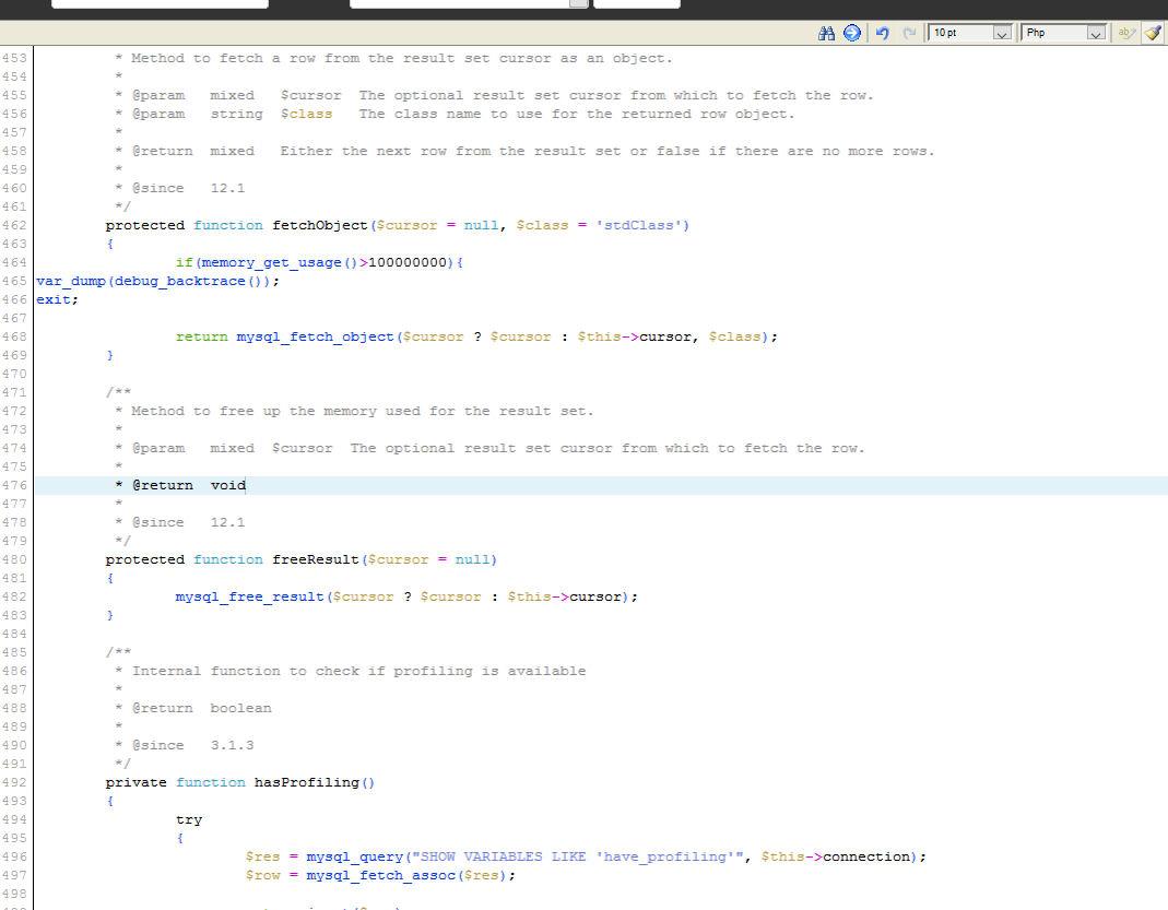

Right see the2 screen dumps sql_1 shows the last code you supplied entered on line 464, this just give a blank screen but as you can see in sql_2 I removed the } and it now give this error;
Parse error: syntax error, unexpected 'protected' (T_PROTECTED) in /home/mohairbe/public_html/libraries/joomla/database/driver/mysql.php on line 480
Line 480 is visible in sql_2

9 years 10 months ago #250553
Well, the thing is that this error doesn't mean that it comes from HikaShop, especially if you have the problem on other things than HikaShop.
So reinstalling HikaShop won't help.
No, this error means that too much memory is being used and thus it can come from nearly anything. Like another plugin/extension loading a lot of data from MySQL.
If the problem is only in the mass actions interface, then there is a high chance that it's something linked to the data in the database of HikaShop or/and how the mass action is configured and maybe there is something to improve on our end for that.
But if you have a similar problem on the global configuration page of Joomla, then the problem is probably not in HikaShop. It must be linked to a system plugin. You can try disabling them one after the other and see which one is causing the problem like that.
Now about your issue in the mysql file ; please be sure to copy paste the entire code we gave you.
Because you missed the final closing bracket. So it generate your PHP issue.

As I said above the Global issue has been resolved and was caused by creating a 'copy' of mysql.php and calling it 'mysql_copy.php' by deleting this file the global is ok again, now the only issue I have is with mass actions and the 'orders plugin'
The closing bracket was there but it looks like I have used the same screen dump twice, with he closing bracket there all I get is a 'blank page'
The only way to get an error message is to remove the closing bracket.
I have not linked anything to the data and I can only assume as I have a high volume of orders that this si somehow causing the problem? I cannot really delete and orders and they are there for customers history.
thanks
