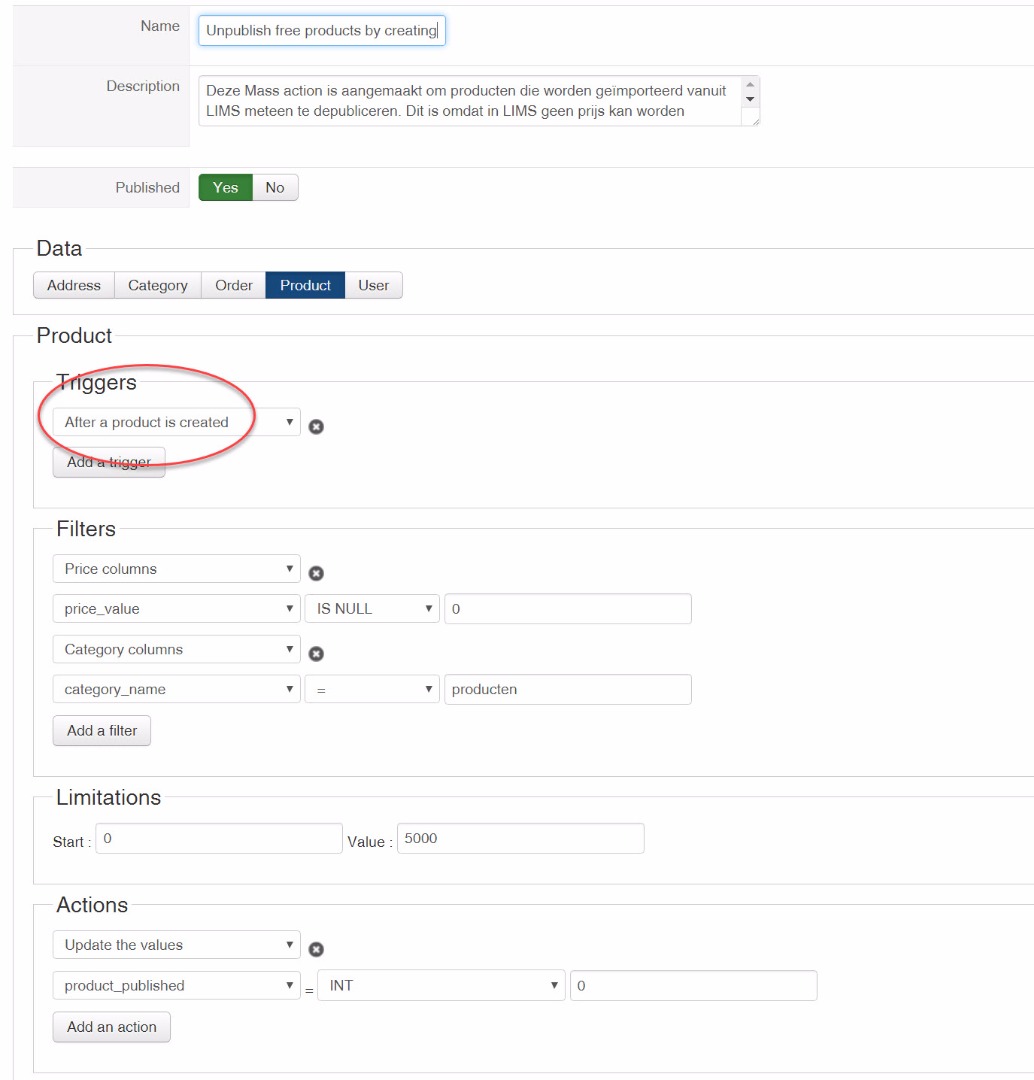

Hi supportteam,

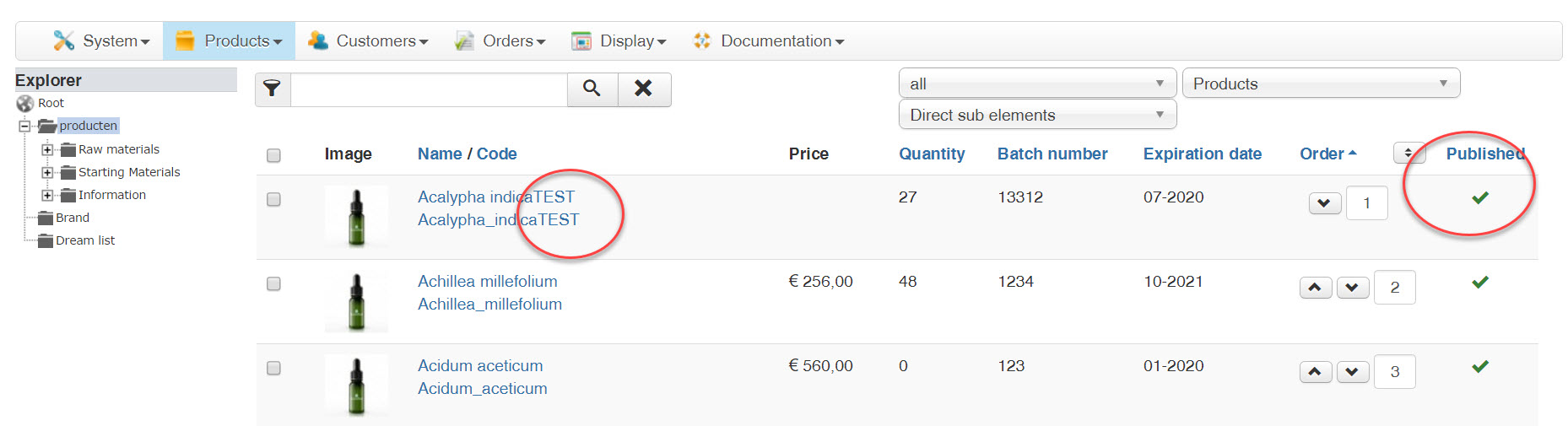

I have created two mass action which only works when you trigger (process) it manually.
The action is to unpublish products whose value is 0.
So it's a simple to check if it's working if you change the productname. Then you do a update but the product is still published when there is no price available.
Hope you can help me.
Kind regards,
Lumiga
See configuration:
Kind regards,
Lumiga

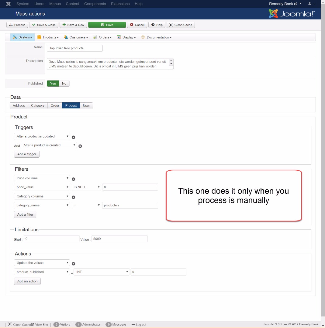

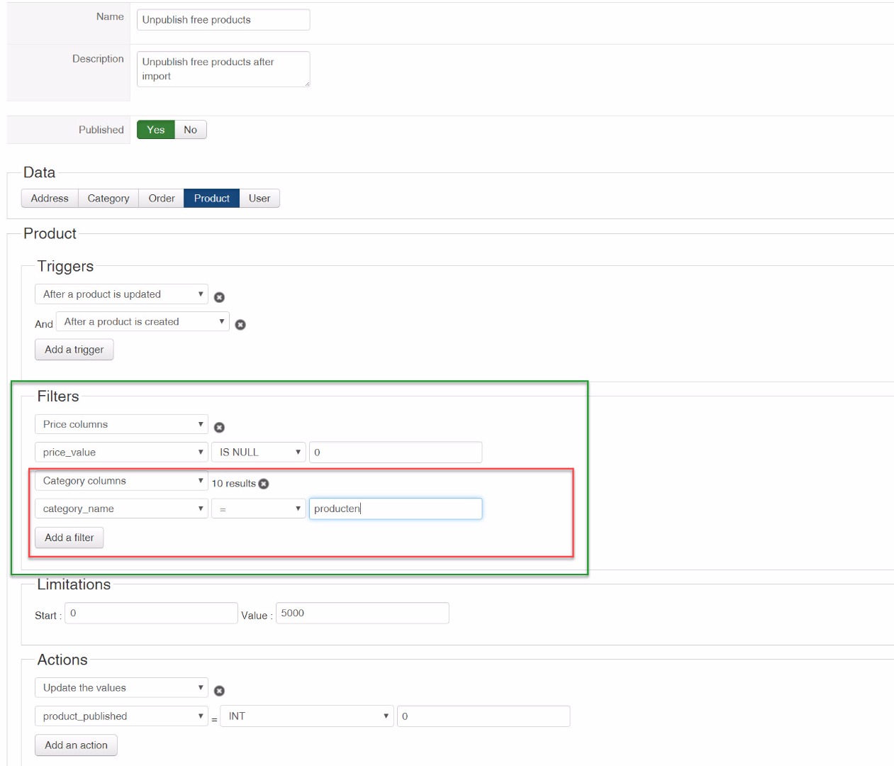

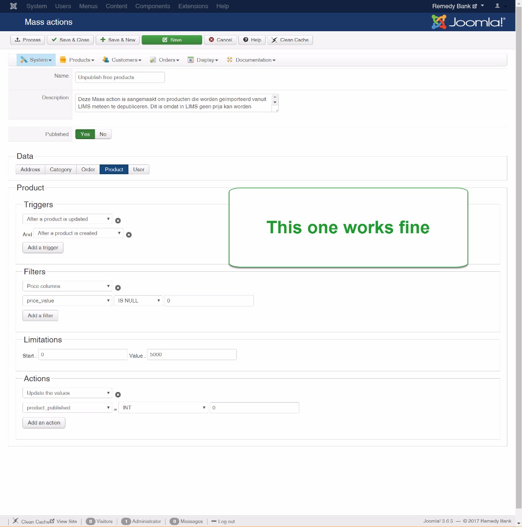

By coincidence I found out that is issue has to do with the Filters.
When I use one filter it works fine, but with the second filter on it doesn't work anymore.
See screenprint:
I have tried the name and also the ID but none of the options works
After updating the NAME, the product is still Published. Also after I cleared the cash.
When I do a manual Mass Action it works fine!
Kind regards,
Lumiga
Last edit: 9 years 6 months ago by Lumiga.

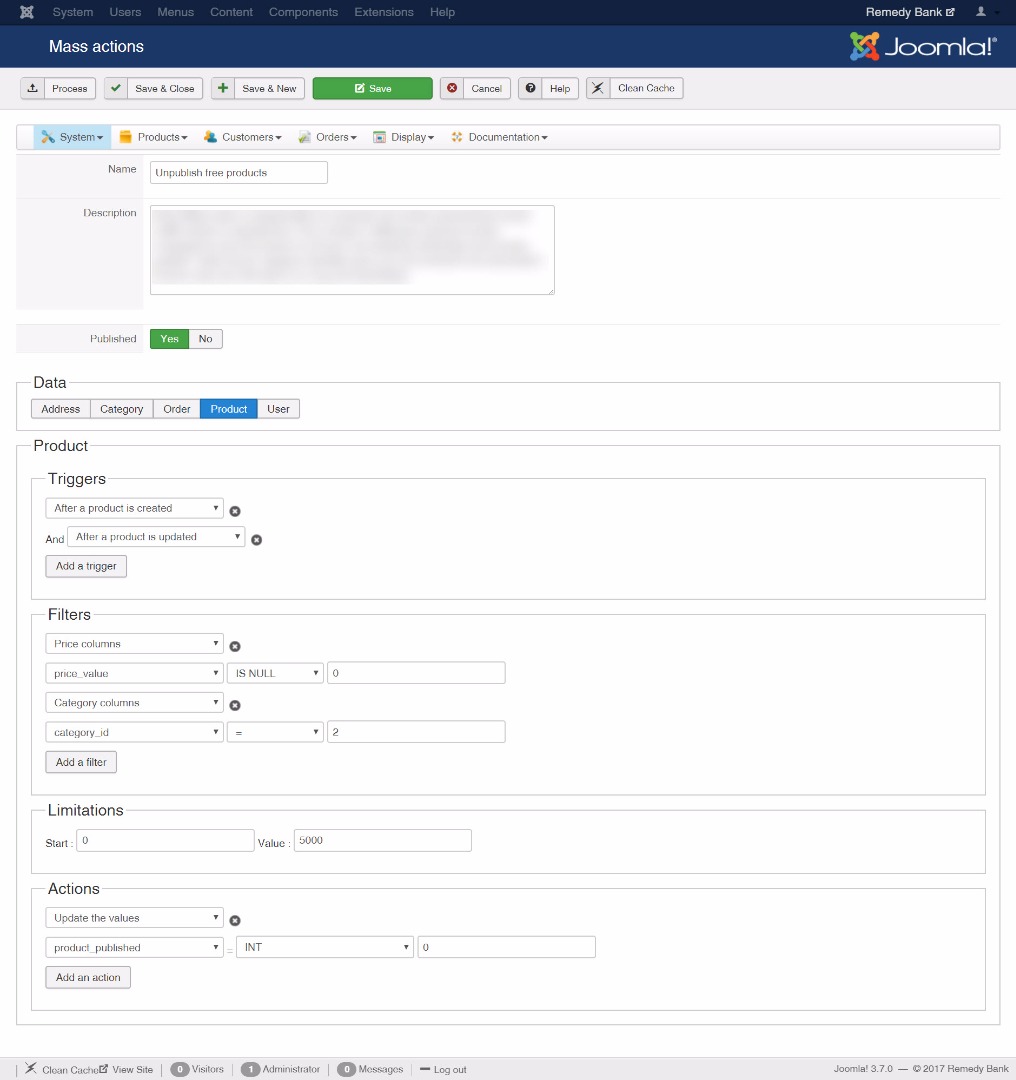

9 years 6 months ago #262146
Can you provide 2 Filters configuration screenshots (worked and non-worked).
Please note that your provided access didn't work for access backend.
Awaiting news from you
  • Posts: 637
  • Thank you received: 26
9 years 6 months ago #262293
Hi Philip,
Here the two screenshots.
Kind regards,
Lumiga
Last edit: 9 years 5 months ago by Lumiga.
