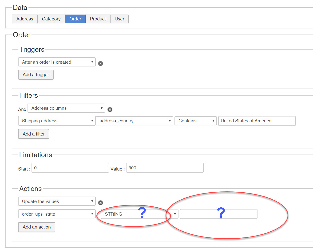

Hi Hikashop team,
I'm busy creating a CSV export for UPS Worldship software.
UPS told us that it's better to not use the state field, only when the package has to be sent to the United States of America or Canada.
So I have create a custom field "order_ups_state" and I want to update the value with a copy of the value from "address_state"
only when the shipping address_country is United States of America. So in all other cases this field will be empty.
So I have create this Mass Action.
The only question I have is how to update the value for "order_ups_state" with a copy of the value from "address_state".
Hope you can help me with this issue.

There is no option in the mass action system to do that.
The update the values action can't use address fields. And even if it could, in the address_country and address_state fields, you don't have the 2 letter code, you have the zone namekey.
So that wouldn't help.
I'm afraid you'll have to develop a custom plugin or script to either fill that field with some PHP and MySQL queries, or handle the export specifically for UPS.
