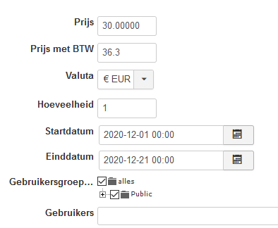

I have products with a temporary discounted price. The price is added as an additional price with start and end date.
Now i would like to move automaticly these products in a discount category. and remove them when this price ends.

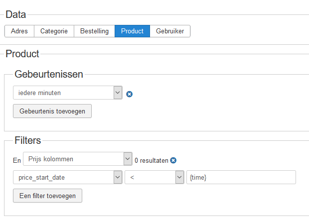

In the massaction i have
price_start_date < {time}
But it counts 0 products
I think {time} isn't working in this case, but what do i need to fill in here?

The {time} tag should work fine on the price_start_date. In fact, it works on my end.
Could you provide a screenshot of the settings of your massaction ?

Hereby some screenshots.

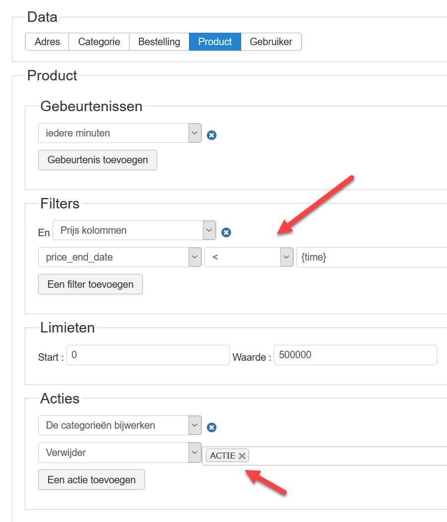

I still have trouble with this option:
I set up the mass action like this ("verwijder" = remove the category ACTIE when the price-end-date is lower than actual date)
Attachment not found

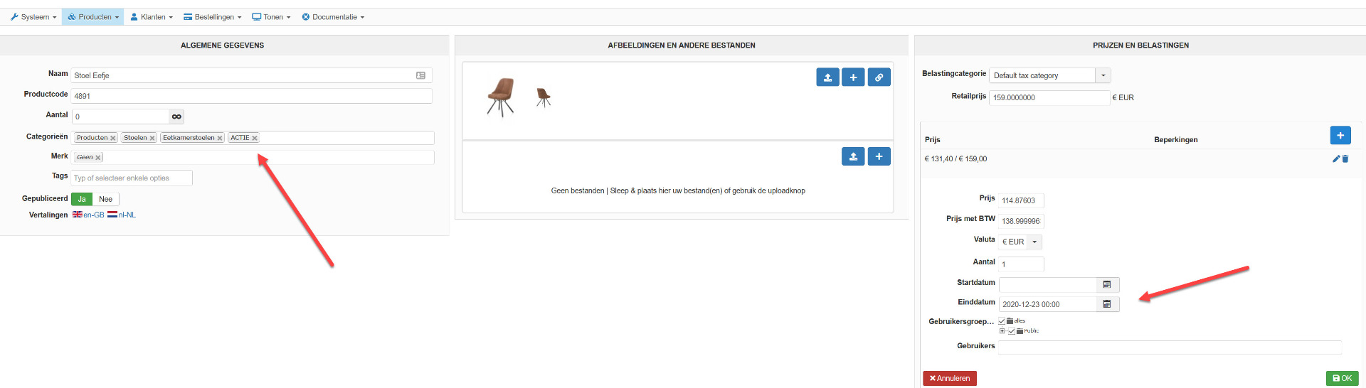

When i look at the product the end date was 23 december but the category ACTIE is still there
Even when i manual trigger this massaction it doesn't work.
Do you have any idea whats going wrong?

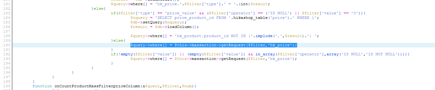

Try changing the line:
$query->where[] = 'hk_price.'.$filter['type'].' '.$filter['operator'].' '.$db->quote($filter['value']);
to:
$query->where[] = $this->massaction->getRequest($filter,'hk_price');
in the file plugins/hikashop/massaction_product/massaction_product.php and see how it goes.

Well yeah. My code fix was to properly process the {time} tag for filters in the "price" table as this didn't without this change.
However, what I see in your screenshot is that it will take into account all the products with a price end date smaller than "now". And when you don't enter anything in the setting it will still consider that it is smaller than "now".
So what you're saying is that my code change does fix the problem you reported initially.
Now you just need to fix your mass action and have a second filter on that same column with the condition "> 0" so that it skips products without a price end date.

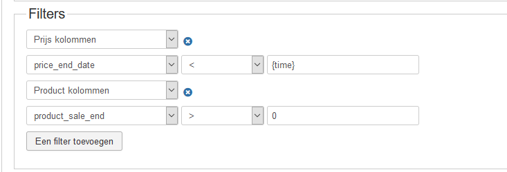

  • Posts: 224
  • Thank you received: 10
5 years 6 months ago #328700
I changed the code:

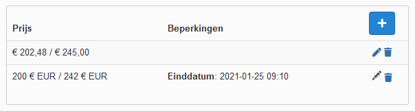

Added a price with end-date (in the past):
And changed the mass-action filters like:
But the product is not removed from the category.
Do i miss something else?
5 years 6 months ago #328704
It's quite strange that you don't have any displayed results in your screenshot, have a look on mine :
A little tricks to create your mass-action, first set your filters and for your action choose display the results & define which columns of your targeted elements to see.
From my screenshot this will display 124 products (results), then define your actions like my screenshot.
If you have defined an action and nothing is processed, then provide your complete massaction screenshot.
Awaiting your returns to progress on your subject.
Last edit: 5 years 6 months ago by Philip.
  • Posts: 224
5 years 6 months ago #328730
Yes it seems to work now.
Thanks Philip
