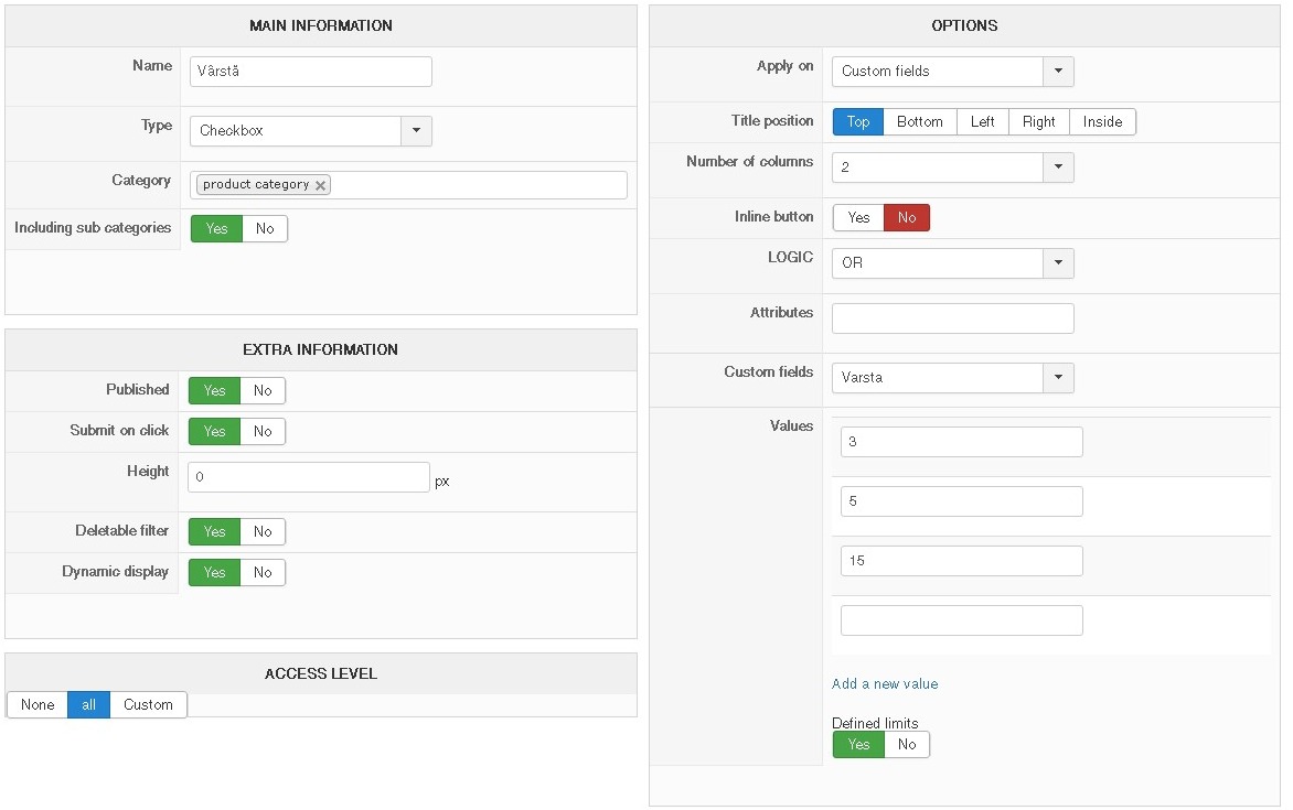

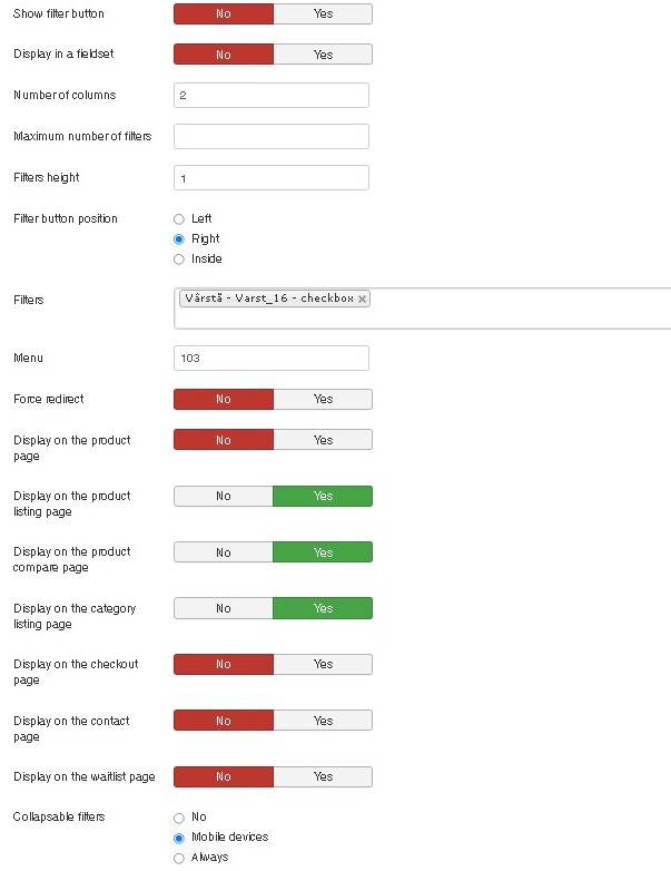

- provide also a screenshot of the settings of your filter so that we can better understand the situation.

  • Posts: 278
  • Thank you received: 42
  • Hikamarket Multivendor Hikaserial Subscription Hikashop Business
5 years 1 month ago #334599
1064 You have an error in your SQL syntax; check the manual that corresponds to your MariaDB server version for the right syntax to use near ') ) ORDER BY a.ordering ASC LIMIT 0, 21' at line 1 SELECT DISTINCT b.* FROM wbj9o_hikashop_product_category AS a LEFT JOIN wbj9o_hikashop_product AS b ON a.product_id=b.product_id WHERE (b.product_published = 1) AND (b.product_type = 'main') AND (a.category_id IN (28)) AND ((b.product_access = 'all' OR b.product_access LIKE '%,9,%')) AND ( () ) ORDER BY a.ordering ASC LIMIT 0, 21

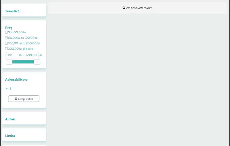

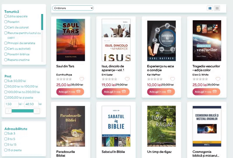

So I check the filter, uncheck and refresh the page.
At the end of gif 2, I refresh the page to see the error.
Let me know if you need more info.

  • Posts: 86104
  • Thank you received: 14204
5 years 1 month ago #334607
Thank you for the detailed answer. That's great !
I've made a patch on our end to fix the issue.
Download again the install package of HikaShop on our website and install it on your website. It will add the patch and it should then hopefully work.
