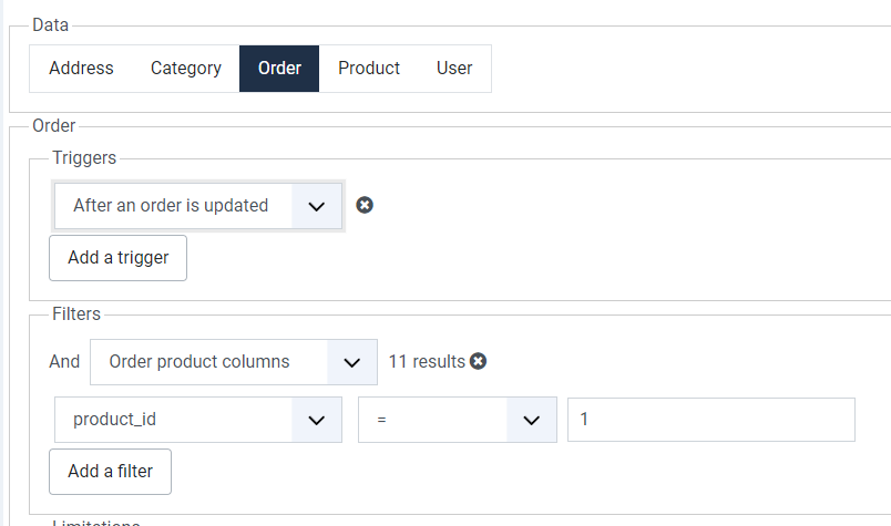

I have triggers setup and working when a product of a certain type (Filter Set to order product column -> order_product_id = 1) is set.
But if an order is then cancelled, i'm trying to create a different Mass Action that can have the same filter as above AND Order_status= Cancelled.
When I set the 1st filter, all OK.

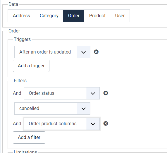

When i then add the 2nd filter, I can't choose the order status to filter on.
If i do it the other way around, i can add the order_status cancelled, and then add the order product filter, but cannot choose or specify the filter conditions . .

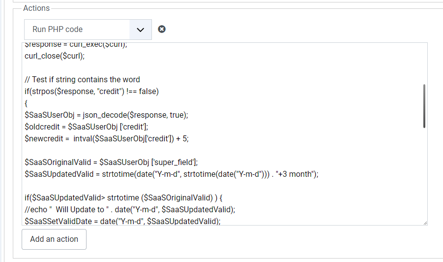

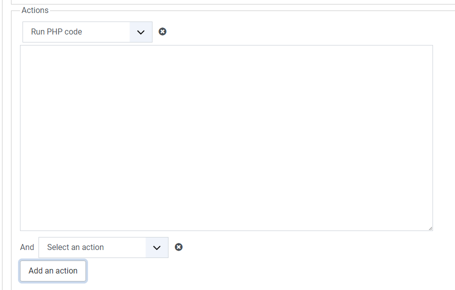

The same type of issue applies for the Actions section.
I can Add an Action but it wipes out the 1st one.
See attachments if not making sense ;)

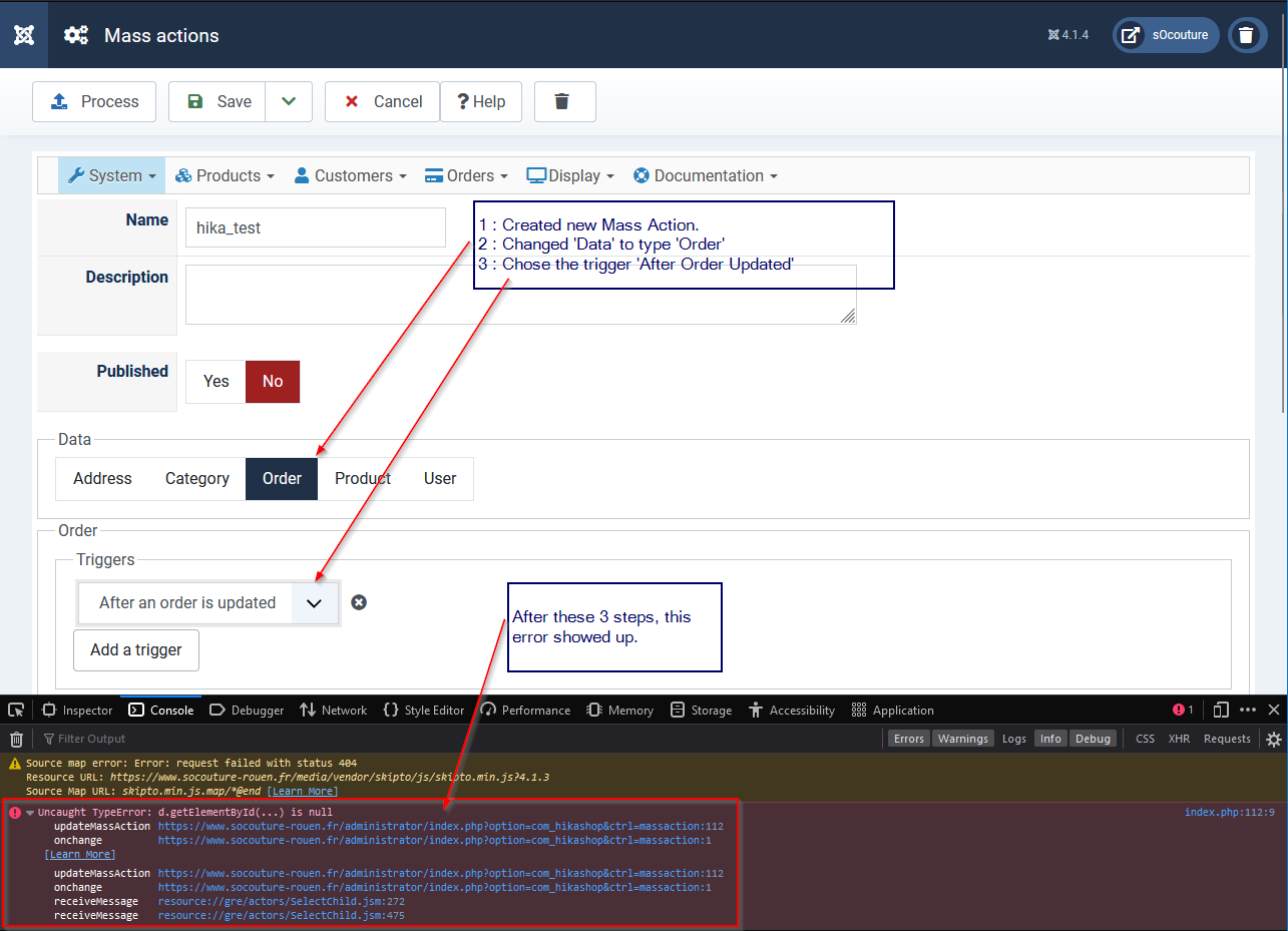

I've just had a look at your backend and I'm not able to reproduce the problem:
i.imgur.com/6v2LRwI.png
Could it be something linked with your browser ? If you try with another browser do you have the issue ? Which browser and which version are you using ?
Do you see any javascript error in the console (F12) of your browser ?
  • Posts: 8
4 years 1 month ago #342189
All on Windows, been using Edge & Edge dev (v103).
i've just tried with Firefox v101 and it seems to behave better...
I'll see how it goes and will let you know.Close the ticket for now and if i get a failsafe way to reproduce what I saw (and over multiple browsers) i'll start a new one.
Anyone else sees this, check if your browser is up to date and try different ones.. :)
Thanks !

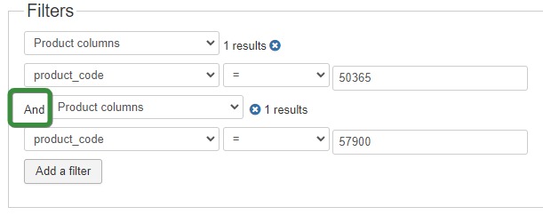

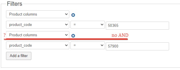

I think I have a similar problem.
When I try to set 2 filters, I get no result and the "AND" attribute disappear
I try to select multiple products by product code
Before executing the mass action
After the mass action was executed and no result was returned
I'm doing this wrong?
