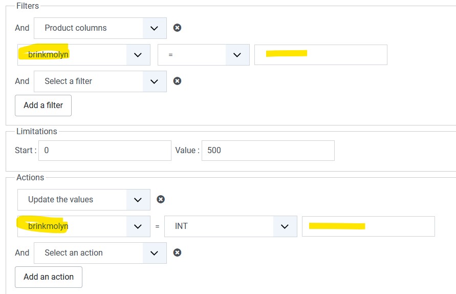

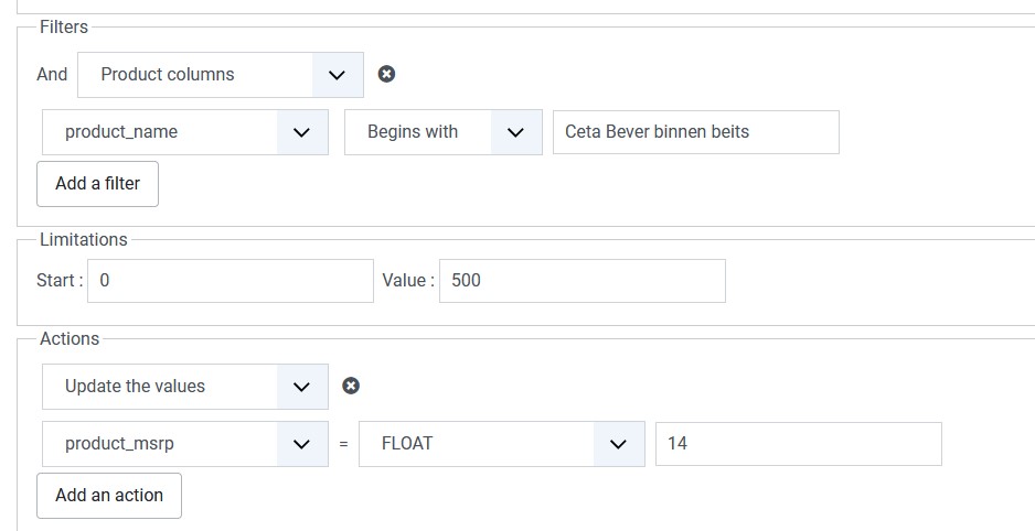

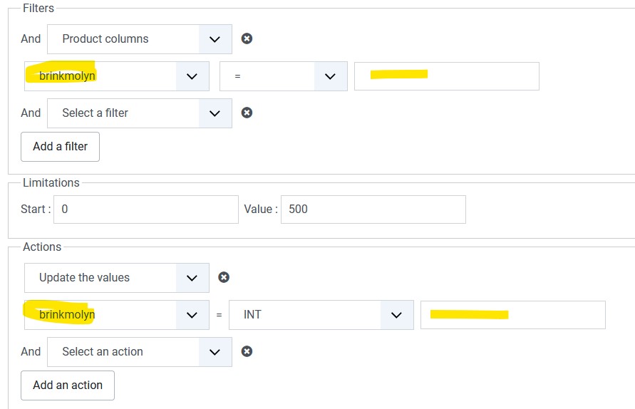

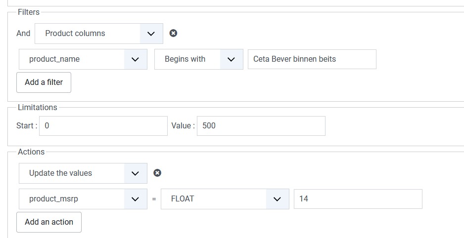

Hi there,
When trying to ad a second filter of action, the first filter / action is replaced. I have this behaviour in Google Chrom and Firefox. There is no javascript-error in the console, and when saving the mass action first before adding a filter / action does not help.

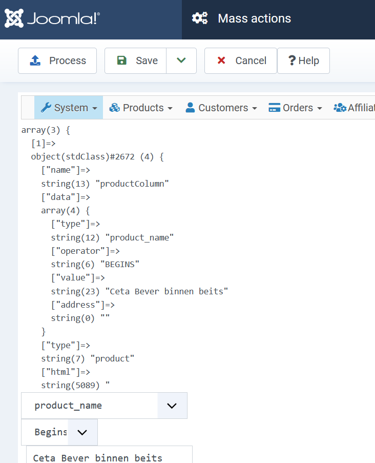

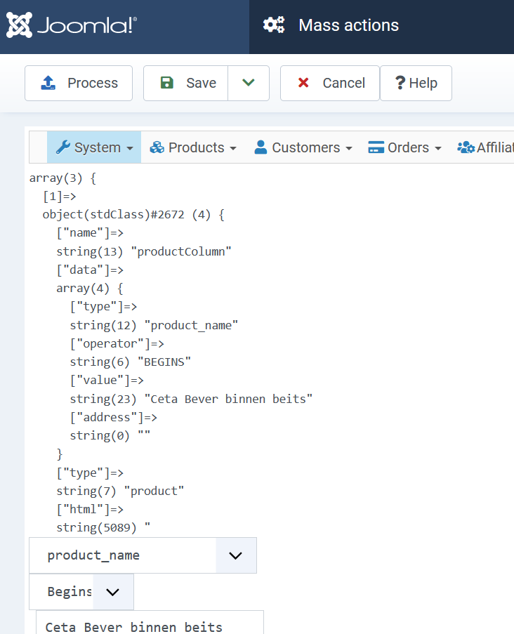

Thank you. I wasn't able to reproduce the problem on my localhost. I think it might be an erratic result of a PHP function based on the version of PHP being used to calculate the max filter already in the mass action.
I've made a patch for it which should help. Please download again the install package of the 4.6.0 and install it again on yours website and it should help.

Just remove the echo / print_r lines that you added for debuggin I guess, and it is just fine.
Peter
