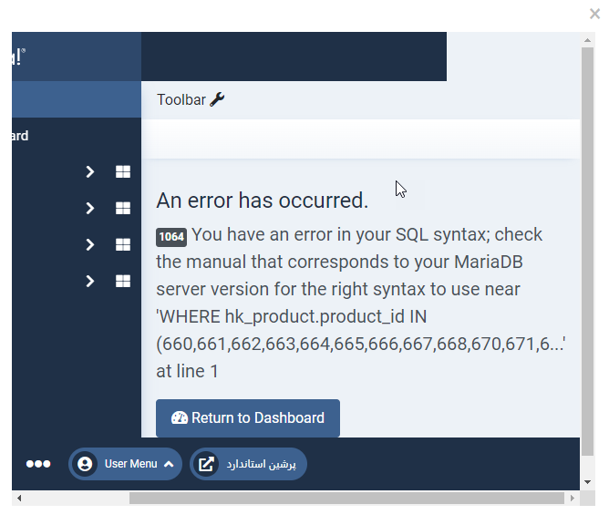

3 years 10 months ago #344357
Hi.
today I tried to use this code.
I put some html instead of "my extra text" and the system returned error.
can't I put html there ?
  • Posts: 233
  • Thank you received: 13
3 years 10 months ago #344358
what I exactly want to do is that if my description's html is :
<p>some text</p>
I want to add :
<div class="class1">some other text</div>
at the end of it.
so the final description would be :
<p>some text</p><div class="class1">some other text</div>
screenshot of the error i get is attached
Last edit: 3 years 10 months ago by khashiz.
  • Posts: 85982
  • Thank you received: 14148
3 years 10 months ago #344359
HTML is stripped for security reasons.
If you want to temporarily disable that, you can remove the line:
$value = strip_tags($value);
from the file administrator/components/com_hikashop/classes/massaction.php
Then, you'll get the HTML in there too when you process the mass action.
