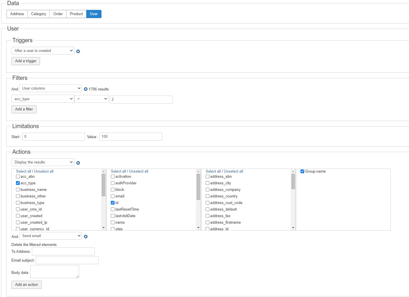

  • Posts: 10
3 years 8 months ago #346620
Sure, we need to split users into 2 groups; retail and wholesale. The retail accounts could be allow to self activate but the wholesale accounts should require admin approval.
I wanted to have a cron disable the user account immediately if they select wholesale and then send an email to admins to check and approve the account manually.
I tried to use the 'after a user is created' trigger (which works fine) but I need to filter just the last account that are in the wholesale group only, not all. I couldn't see how to only filter for the last created account etc.

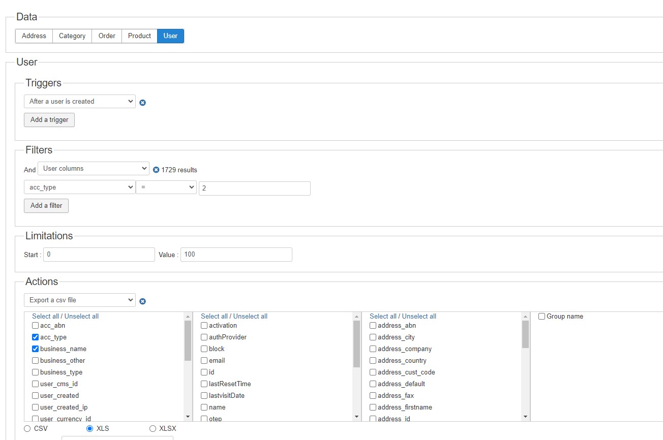

  • Posts: 10
3 years 8 months ago #346667
Ok I think I still need to filter to check if the user registered for wholesale or retail (which I can do) but when I test the mass action to 'display the results' it shows all users in the wholesale group in the table. I would hate to deactivate all wholesale users every time someone registers.

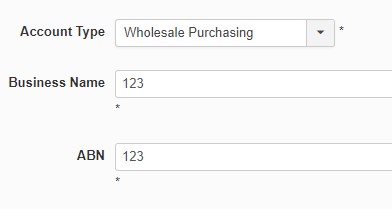

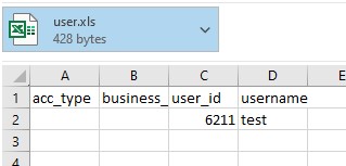

  • Posts: 10
3 years 8 months ago #346749
Yep that helped me a lot to see whats going on thanks. However I've hit one last issue with this.
I am outputting a xls file for testing as you said and in that I'm looking for a custom user field 'acc_type'. This field is working correctly as I can go into the user page in the backend of the website and see the field with the user selected value. BUT the xls file, shows a blank field. This field was meant to be used for the user to select retail or wholesale and I only need to tack action on the wholesale users.
So why is the database getting the custom field data but the mass action can't see it?

3 years 8 months ago #346757
Thanks for the details. So I looked into it and I have the same behavior on my end.
HikaShop has a user synchronization plugin, which has, among other things, the capability to add the user in HikaShop when a user is created from Joomla or from another extension. And since the HikaShop registration process adds the Joomla user before it then adds the HikaShop user (so that it can user the id of the Joomla user in the HikaShop user entry as reference), the user synchronization plugin would add the user in HikaShop while Joomla would add the user in Joomla, undercutting the registration process.
This would usually not be a problem since it just means that the saving done by the registration process for the HikaShop user data would end up as an update, and not a creation.
So that's why your mass action would be empty. The "after a user is created" event would actually be before the user data would be saved by the registration process.
So I've made a patch to the mechanism so that the user synchronization plugin will skip the synchronization if the Joomla user creation happens from HikaShop's registration process. It then now properly triggers the "after a user is created" and not the "after a user is updated" when saving the HikaShop user data in the database during the registration process.
To get the patch, download the install package of HikaShop on our website and install it on your website and that mass action should then work fine, like it does on my end.
