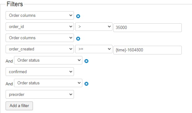

I have configured filter like in attachment.
I need to export ALL orders with status confirmed and preorder. With that setings I get only preorder.

3 years 8 months ago #346264
Your filter on order created may be the issue, change it for this :
Note : When you create/add a filter the result is dynamically displayed (here "3 results" on my screenshot), this will help you to define your massaction step by step.

3 years 8 months ago #346301
Order created is set as {time}-1604800. So all orders created 19days ago.
That filter works ok.
The problem is with order status. I only can get one of them in export.
So in result should be some preorder and some confirmed.

3 years 8 months ago #346304
Whatn you want want is the orders with the status confirmed OR preorder. The order status for one order can only be one, not two at the same time.
So you can't have two filters on the order status as they would use the AND logic, which you don't want here.
The solution is to use a filter "order column" with the operator "REGEXP" and the value
(confirmed|preorder)
That way, it will do the OR inside the regex
Last edit: 3 years 8 months ago by nicolas.

3 years 8 months ago #346307
Thank you. That worked.
