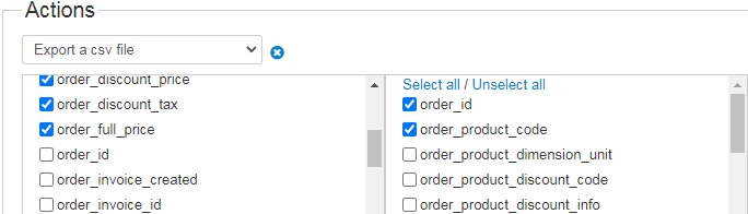

-- HikaShop version -- : 4.7.1
-- Joomla version -- : 3.10
-- PHP version -- : 7.3
After update from 4.7.0 to 4.7.1 massaction export have wrong (changed) order of columns.
We use that to import to our accounting app, but now cant import becouse order of columns are changed.
For example if you look at S column. It should be order_product_price. Name of column is ok in both cases. But data in columns are wrong. In new export there is product name in order_product_price column.

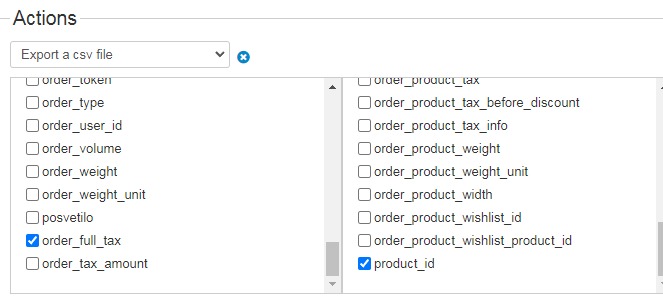

Further investigation shows one more thing.
When I try to create new massaction, in first select is missing order_full_tax.

Thanks. Looking at the situation on your website, I found that you had selected the "order_id" in the order_product selector, not in the "order" selector. And that caused the issue with the XLSX.
I was then able to reproduce the problem on my local test website.
That way I was able to do some debugging and found what was the problem.
I've made a patch and it is now working fine for me.
I've included the patch on our end. To get it on your website, download the latest version install package of HikaShop on our website and install it on yours.

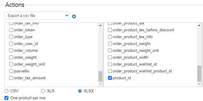

  • Posts: 431
  • Thank you received: 22
3 years 6 months ago #349482
Columns are now proper align but Now I have new issue. See attachment.
Order_id column is duplicated.
If I delete duplicated column in xls my import works.
  • Posts: 86178
  • Thank you received: 14214
3 years 6 months ago #349483
Disable the order_id column from the order_product area and activate it in the order area and you'll have only one order_id column.
  • Posts: 431
3 years 6 months ago #349520
Then the order of columns is broken. Can in some way be duplicate order_id column in order product area be fixed?
  • Posts: 86178
3 years 6 months ago #349572
It's not really a duplication. The first one is the order_id from the hikashop_order table. The second one is the order_id from the hikashop_order_product table.
When you export an order without any products, the first one will have the id of the order while the second one will be empty.
The first one is added to all the export files. I'm not sure why this is done. I suppose it is used in some cases to link the other data of the order with the order itself.
However, removing it doesn't cause any issue in the tests I did. So we probably could remove it. The column was actually added to the export in a wrong way when it was first added, 10 years ago. Recently, I stubbled on that piece of code and saw the code was incorrect and thus I fixed it, which led to the column being in the CSV even if you don't select it.
I suppose it would make sense to not have it since it can be selected anyways and it doesn't cause any issue not having it as far as I can see.
For that, remove the line:
$params->action['order']['order_id'] = 'order_id';
in the file plugins/hikashop/massaction_order/massaction_order.php
I'll look at adding that change for the next version of HikaShop too.
