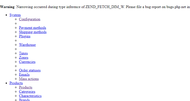

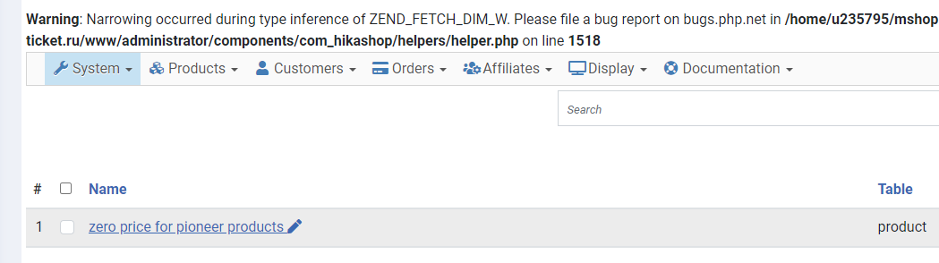

-- HikaShop version -- : 5.0.0
-- Joomla version -- : 4.3.4
-- PHP version -- : 8.0.0
-- Browser(s) name and version -- : Chrome 118.0.5993.89
-- Error-message(debug-mod must be tuned on) -- : Warning: Narrowing occurred during type inference of ZEND_FETCH_DIM_W. Please file a bug report on bugs.php.net in /home/u235795/mshop.svc-ticket.ru/www/administrator/components/com_hikashop/helpers/helper.php on line 1518
Fatal error: Allowed memory size of 89128960 bytes exhausted (tried to allocate 20480 bytes) in /home/u235795/mshop.svc-ticket.ru/www/libraries/vendor/joomla/database/src/Mysqli/MysqliStatement.php on line 550
Fatal error: Allowed memory size of 89128960 bytes exhausted (tried to allocate 65536 bytes) in /home/u235795/mshop.svc-ticket.ru/www/libraries/vendor/composer/ClassLoader.php on line 476
After some time I can't create a New mass action or open already existing one.
If I try to open an existing MassAction or create a new one - I redirected to a Main Hikashop menu with Fatal Error:
Try to execute it both on a local machine and remote server - result is the same.

The warning is something we've reported to PHP : github.com/php/php-src/issues/8251
The issue is still open. If you can update to PHP 8.2, you would get a warning message with more accurate information which would help us explain to the PHP developers in what circumstances the issue happens.
