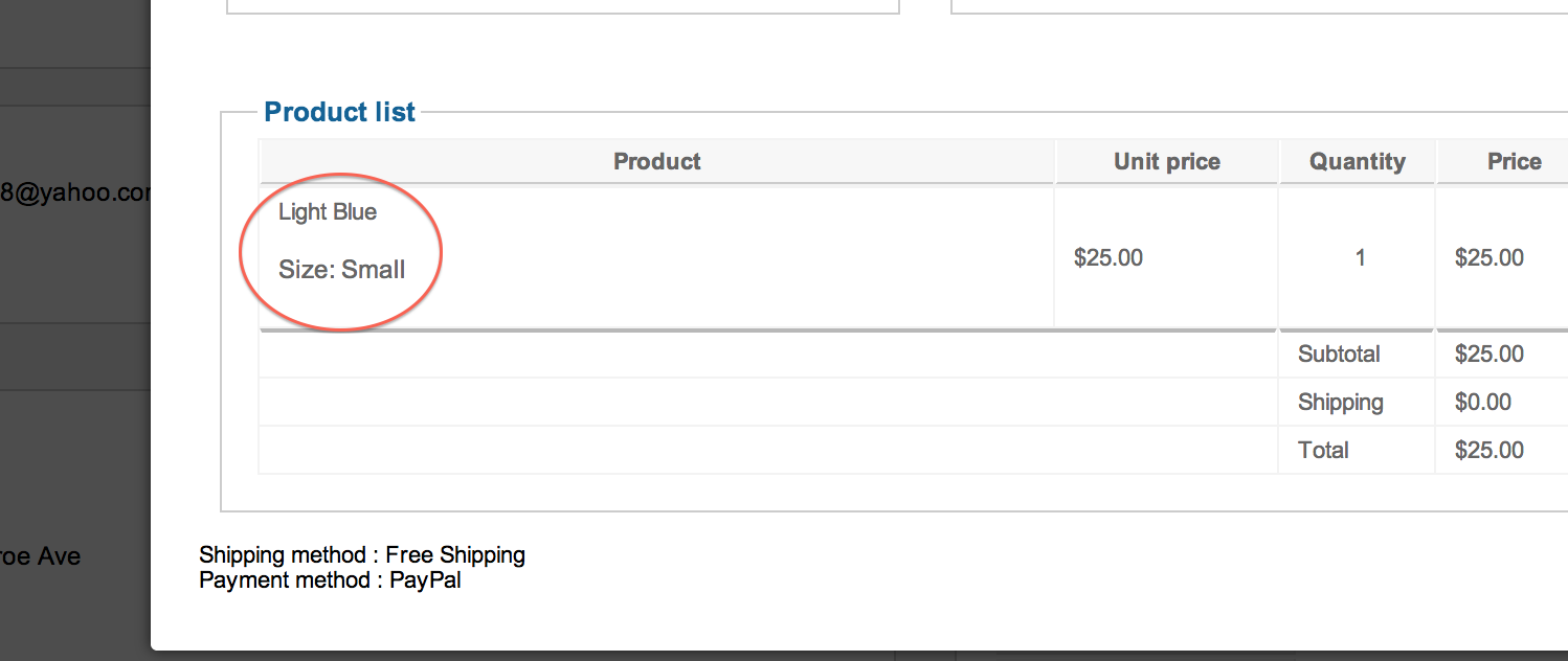

Hello- Can you please direct me to the files that I can edit to show the characteristics name on the invoice? I do not want it on the product page, so I have that disabled. But I would like it on the invoice, as it appears on the order screen in the backend.
I did numerous searches and saw to edit the file order/invoice, but I couldn't find such file, nor would I know what to do if I did find it.
Shown is picture of the invoice now, the product name and custom field is shown, but not the characteristics.
Thanks in advance!!

You'll be able to edit this file through "Hikashop->Display->Views" by editing the "invoice" file of your "order" view of your back-end template.

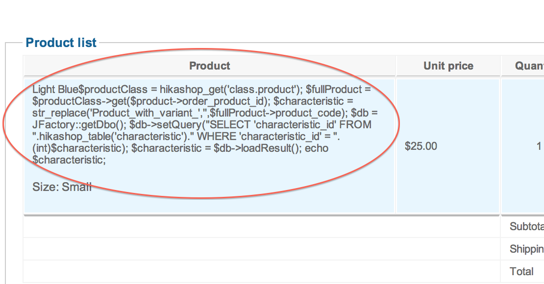

Thanks guys. I am still having a bit of trouble. Here is the best I could do:
It's in the right place, maybe the code is wrong? Maybe I placed it wrong? I don't know what to look for.
Thanks for you help.

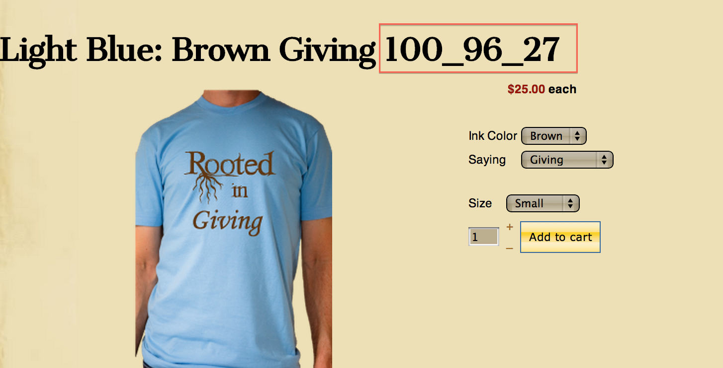

I would like to display the product code on the invoice but not the product page.
The characteristics are set to show on the product page, and that works. But I would like the code on the invoice but not the product page. Is it possible?
Thanks for all your help!!!!

You added the code in the HTML of the page, not in the PHP code of the page. So you need to add the tag <?php at the beginning and the tag ?> at the end so that the code is interpreted and not simply displayed like you have on your screenshot.

Thanks Nicolas. I think there may be an easier way to do this. How can I remove the product code from the product page? I would like to remove the numbers in the box.
Last edit: 12 years 10 months ago by word.
12 years 10 months ago #128490
By using this css property:
.hikashop_product_page .hikashop_product_code_main{ display: none;}
