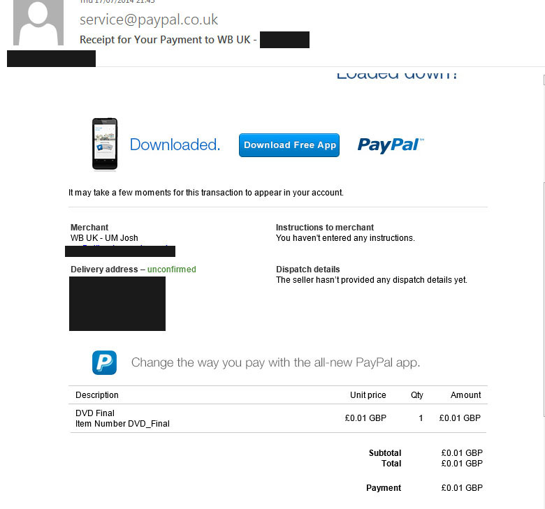

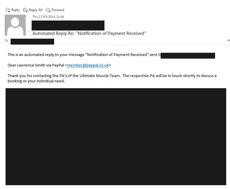

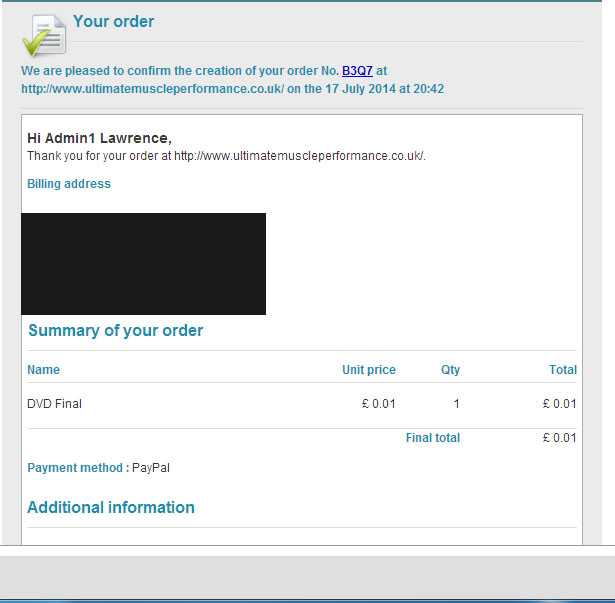

Not having any luck at all with this, I have taken two screenshots to show both emails are the same.
I received 4 emails, two to the email account that I'm registered to on the website and 2 sent to my email that is registered with my paypal
But I am still not getting a downloadable file
Emails sent to my account email
Emails sent to my paypal email

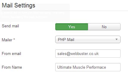

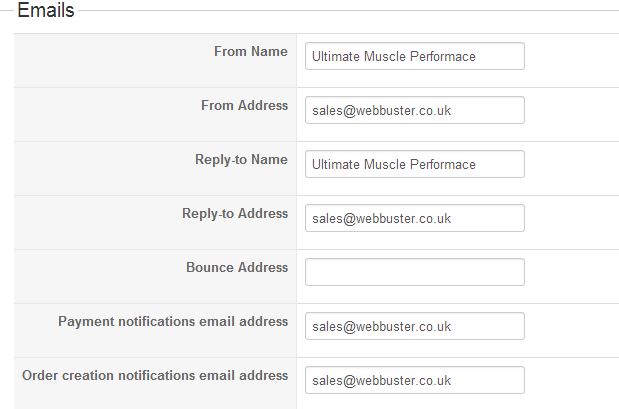

These are the details I have used in the back end
Please help, I'm tearing my hair out

So from what I can see of your emails, that would indicate that the order has not been confirmed because no payment notification has been received from PayPal by HikaShop.
Can you check the status of the order in HikaShop ? Could you do a screenshot of the history area of the order ?
