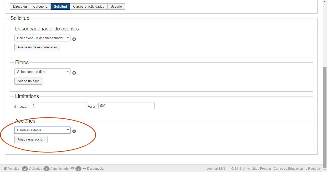

I have tried to make the settings that you have shown me . But this is the result , I can not establish the new state.

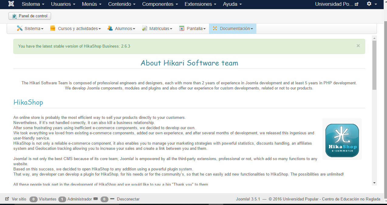

Do you have the latest version of HikaShop ? We fixed several issues with the mass actions system for each of the last releases of HikaShop. So maybe updating would fix the problem if you don't have the latest version.
  • Posts: 267
  • Thank you received: 5
10 years 2 months ago #243987
Hi Nicols,
Yes , I have the latest version . It may be for updating to php7.

10 years 1 month ago #244135
When you select the action "cambiar estatus" please press the save button, then the statuses will be displayed.
We will solve that issue on our end for the next release.
