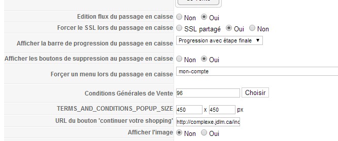

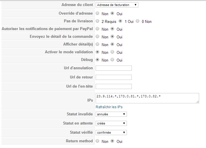

Hi. We have been having issues with Paypal Instant payment notifications. I have attached a file that explains it all and we receive an Invalid Transaction from the debug mode. What shall we do about this, had lot's of specialists looking into this and all of them refer me to Hikashop will know about this.
I also added the Plugin config which always been the same.
Also added the Configuration page.
Thanks for checking into this.
